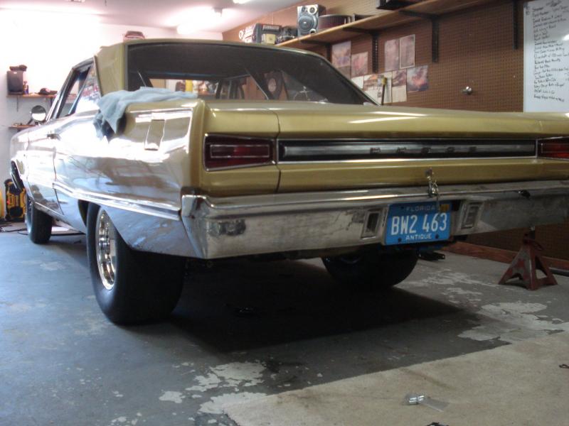

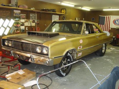

This is right as I was going to use flattop pistons at zero deck in my 440 stroker and I use the Indy EZ heads with 75 CC chambers and .039 head gaskets. My setup would have been close to 12.0 comp which was not good for me since I was building a pump gas car. So I ended using the D-dish pistons that dropped my comp to 10.6 and it still has good quench since the D-dish piston still has a flat area on it for quench. My 63 weighs just over 3700 lbs and with 10.6 comp on pump running through the full exh system it has run 10.70's. You can get the comp you want using the flattop piston with the D-dish with the 75cc heads which I would do as most feel as I do that the flattop piston setup with quench is better to run then using a pop-up piston. Good luck , Ron

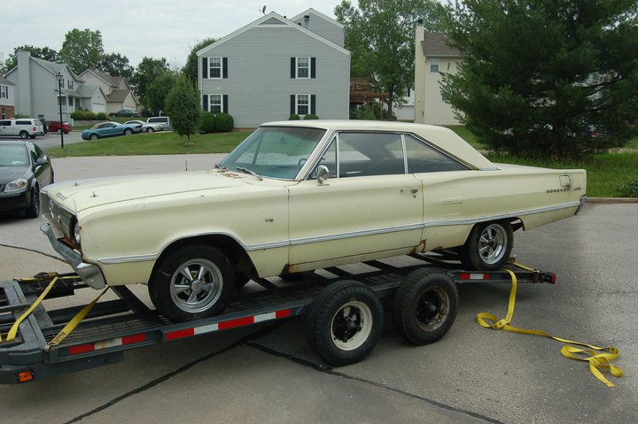

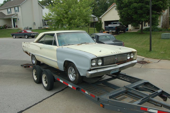

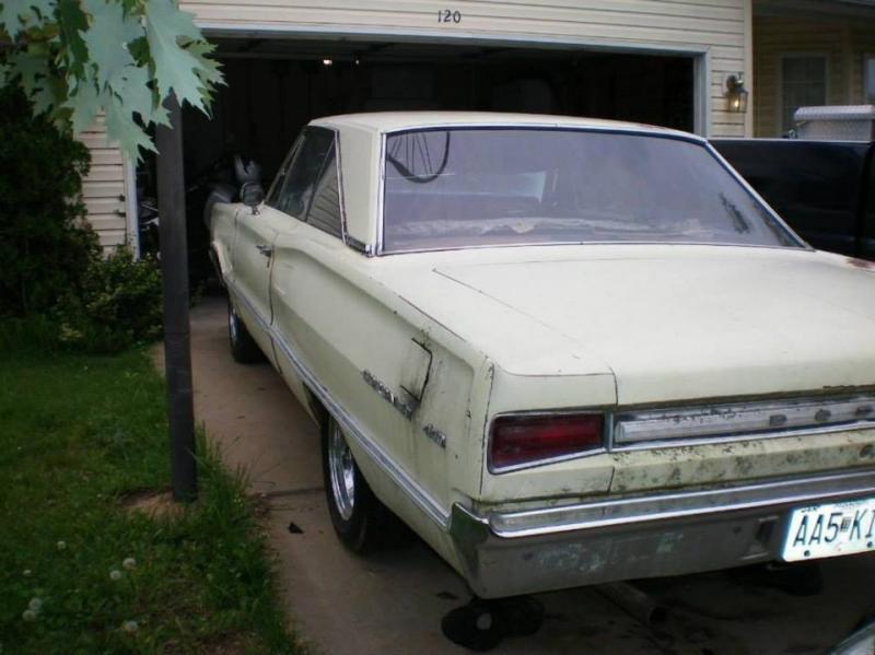

Very very nice car. But I,d like to see when it was built.
Very nice car. But I,d like to see when it was built
