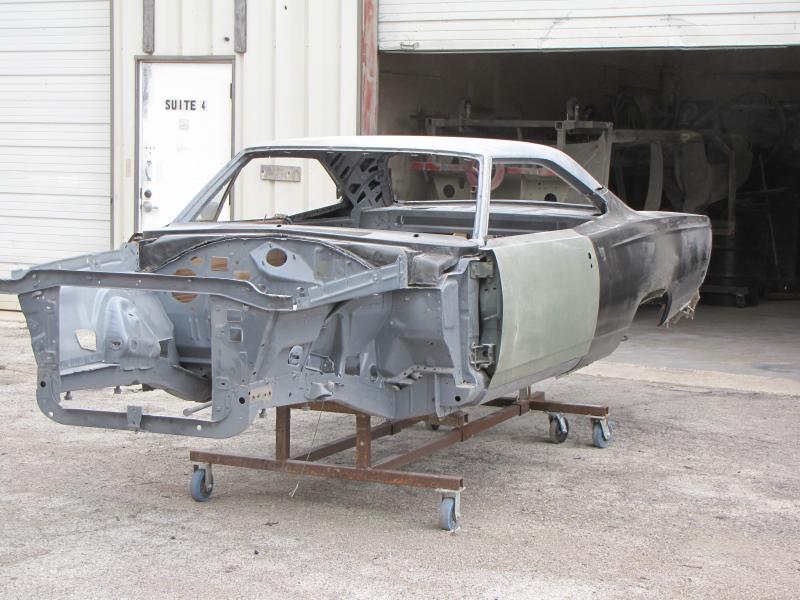

I got the other qtr on, not welded, but screwed in.  Both doors also are on, I have yet to do the deck lid alignment, it will be a PITA as the struts that held the deck lid on were removed years ago, but, I eyeballed where they should go, screwed them down there on the inner wheelhouses, we shall see how it pans out!  What I've learned and observed:
AMD makes awesome parts, the qtrs are easier to fit than I anticipated!
Hanging a wheelhouse also with the qtr panel is more difficult, but doable!
It's an easier process than I ever anticipated, but, have an extra set of hands to help align the panels
Why mess with skins, when you can do the entire panel, far less welding this way
