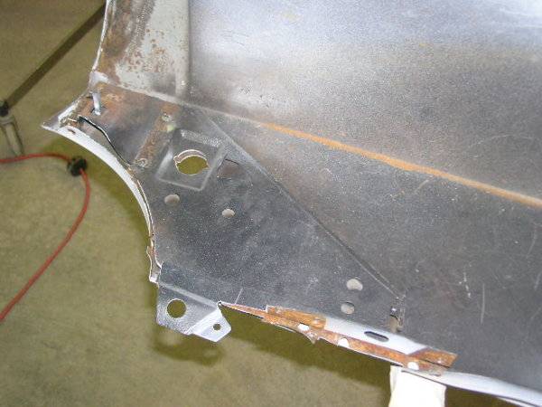

Ok next area to fix on these fenders is the front nose.
Stay tuned.......
So what I have is one fender with the nose a bit to blunt (passenger side)
And the other (driver side) that is just a mess and needs a lot of work (surprise surprise)
Looks like hammer and dolly work in your future....

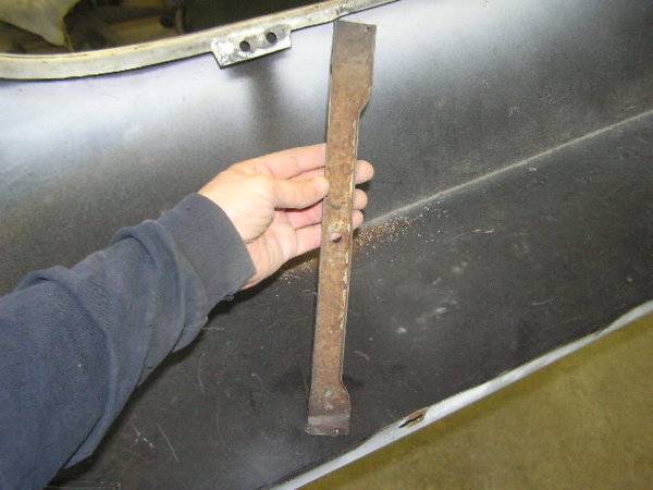

Hi SGT, you are right it was NO fun! (I did this almost 6 months ago and am just now getting this thread updated!)
I had already removed the headlight bucket support
and because I want NO rust, I went ahead and removed the inner antenna support
and wheel well brace. These will get blasted and repaired if needed
