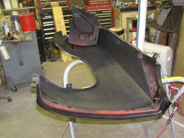

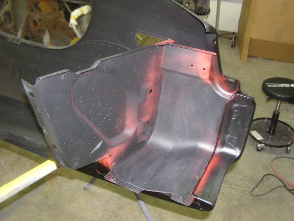

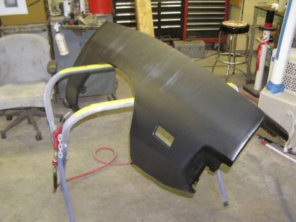

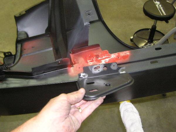

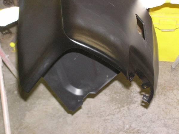

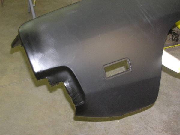

Ok these next few pics are gonna be a little out of sequence, but for now we will stay with the pass side fender.
I welded in the headlight buckets (pilot alignment holes used) and the inner lip of the fender. (Sorry I didnt get enough pics of this) I will show a few more pics of the inner lip on the drivers side
the face of the fender painted looks like you just pulled it out of the box. looks great, and original mopar metal

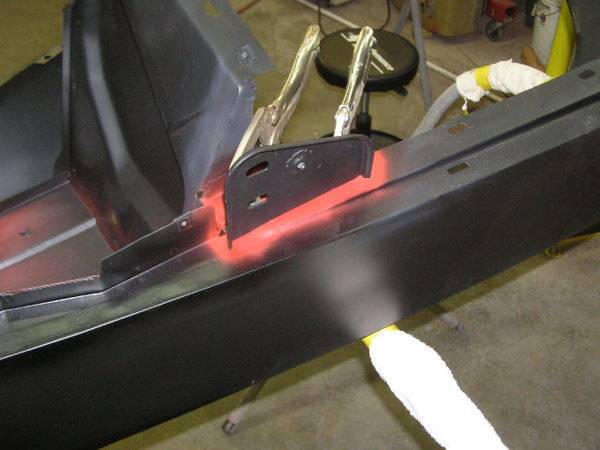

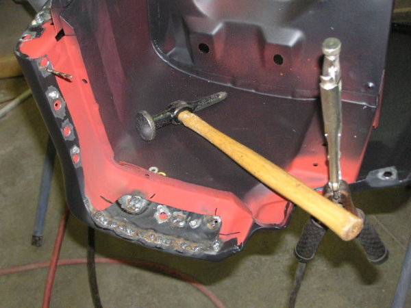

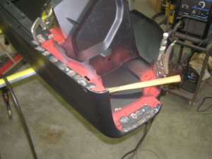

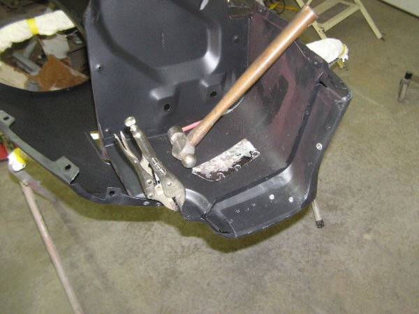

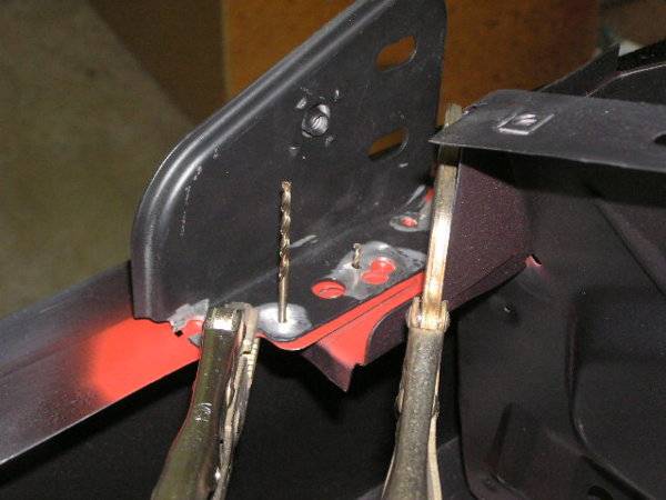

As promised here are some pics of the driver side showing how I did that inner lip.
So here you can see I used those alignment holes and screws to hold the bucket and inner lip patch. I did check the shape with my profile templates (which was good)

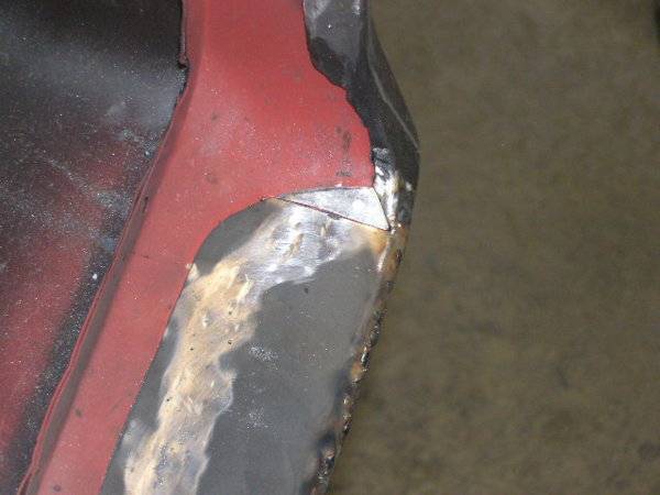

So I took it apart and prepped the metal for welding and tacked it together
added these two wings to make it like it was originally

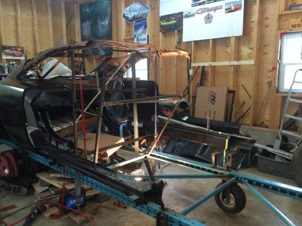

SO time for an update!

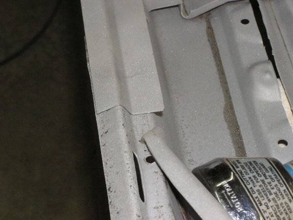

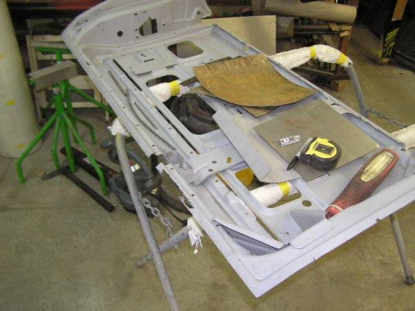

The last thing on the list before I can start welding everything is the doors.
I have 3 sets of doors, so you would think I could get one decent set? AH NO!
I will not bore you with a bunch of pics but I ended up taking every door apart and de-skining each one looking for something to use. I ended up buying AMD door skins and picking the best inner doors I could. Unfortunately they needed patching.
SO HERE WE GO AGAIN
Both inner's need new metal along the bottom, so I bent some strips up and went to work.
