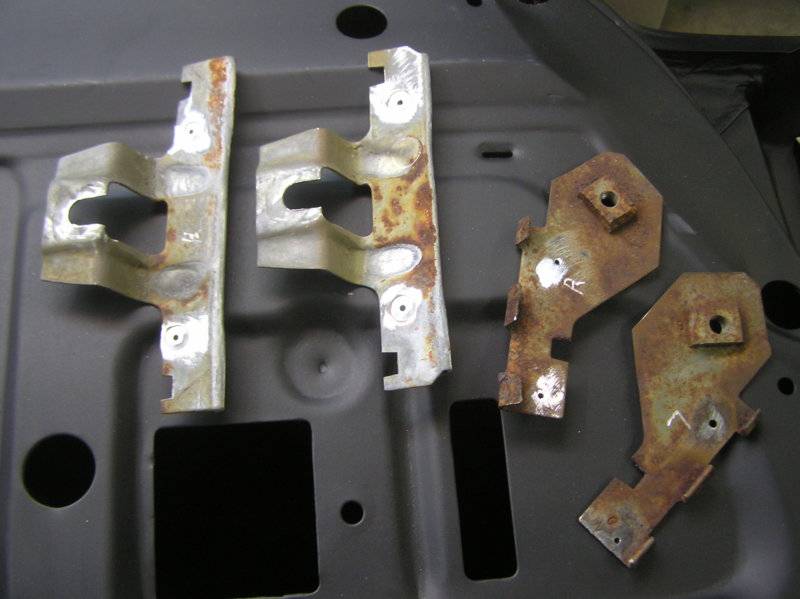

Thanks for the pictures! Know I know where the brackets go!
Glad to help!

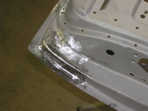

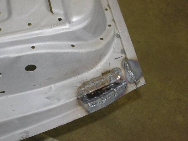

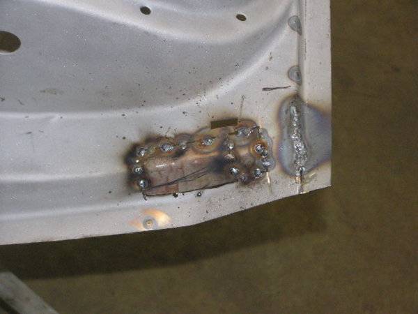

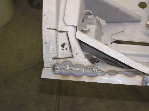

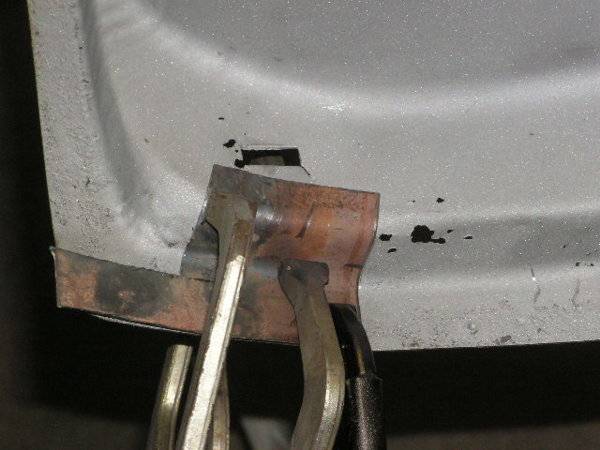

Those door repairs look great! I did the same on mine, had to patch the front and rear lower corners and a few weatherstrip holes. Much cheaper than skins and I actually enjoyed doing it. You're making nice headway, keep it up.

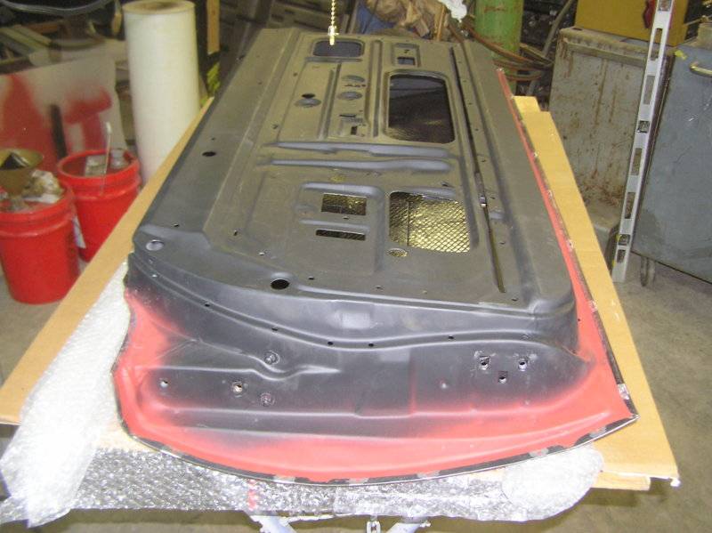

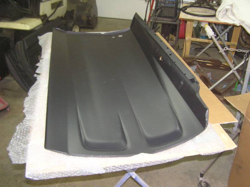

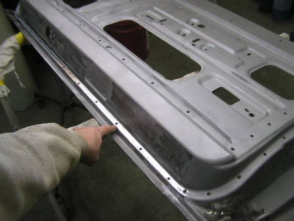

My door skins came in

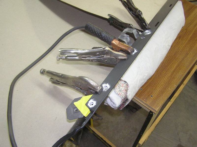

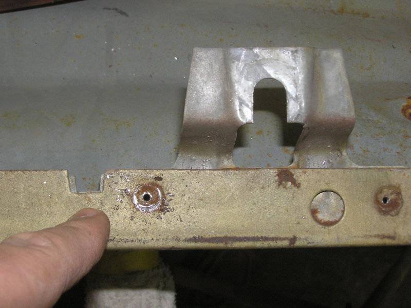

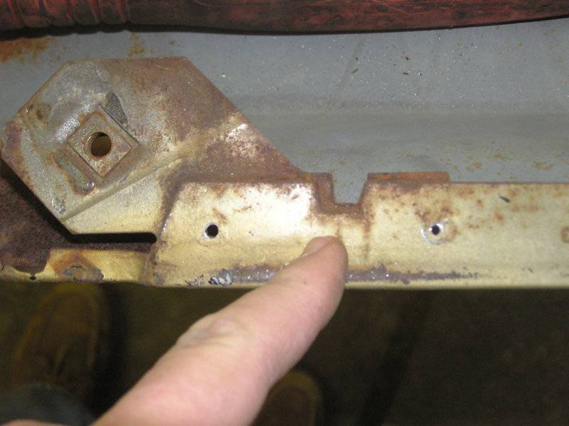

I removed these brackets from the top window edge of the old door skins

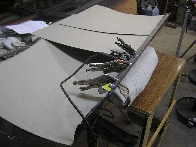

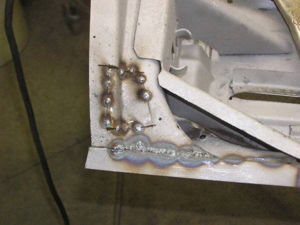

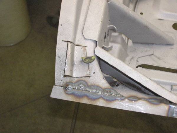

So once I got them were I liked them I welded them in.
(I had to assemble the glass and vent wing to make sure they were in position)

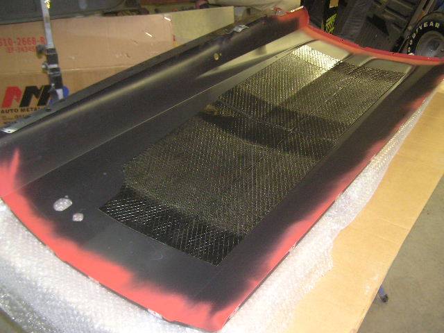

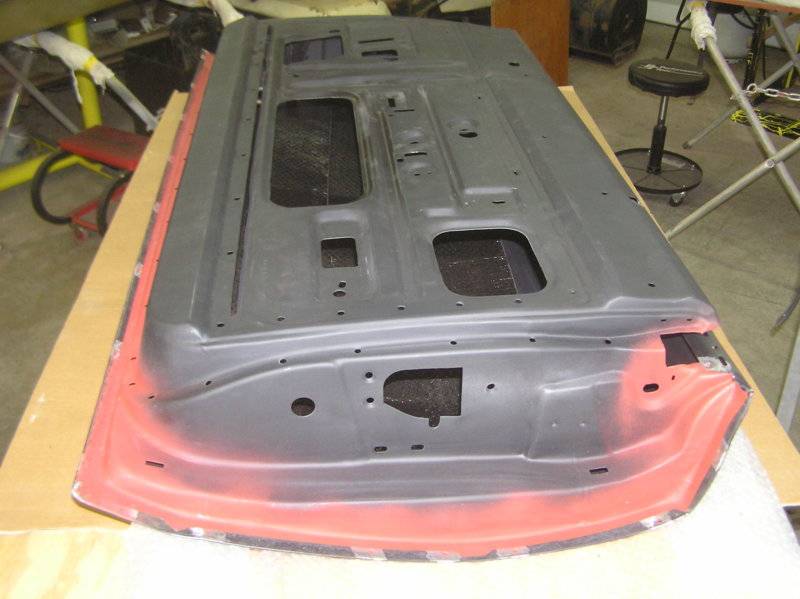

Then I punched some holes in around the perimeter of the door skin (for plug welding)
Next I installed the sound deadening pads

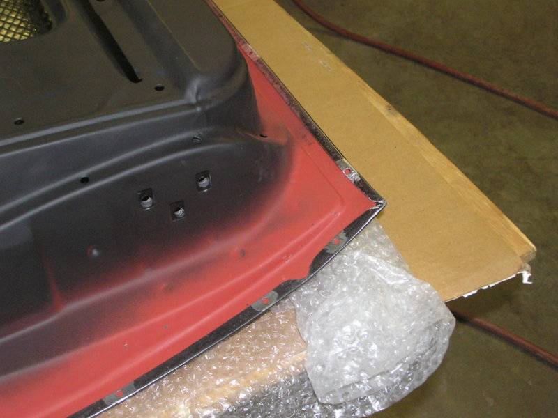

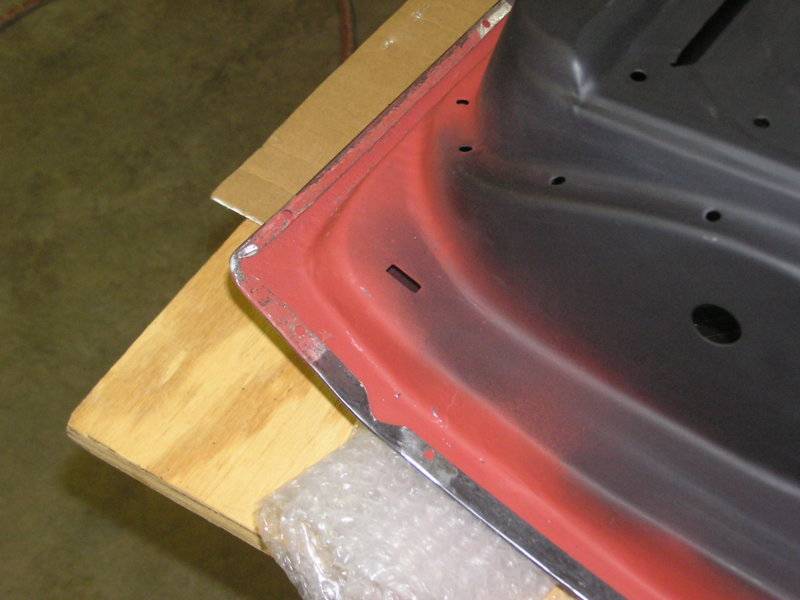

And then I installed the skin, bending over the lip.
I used a hammer and dolly, and a hockey puck for a dolly. I was very careful bending a little at a time. Checking my progress along the bottom with a straight edge. (level)
I will hold off on welding the door skin until I get all of the panels on and fitted. This will give me a little bit of adjustment with the skin.
It all turned out very well!

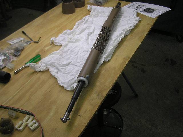

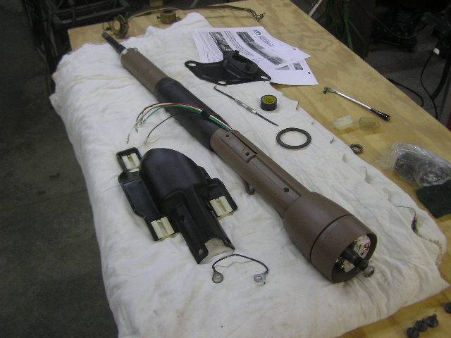

I layed out my steering column parts to reassemble.
note: I used this article to help me in reassembly
http://moparconnectionmagazine.com/...-restoration-turn-signal-switch-installation/

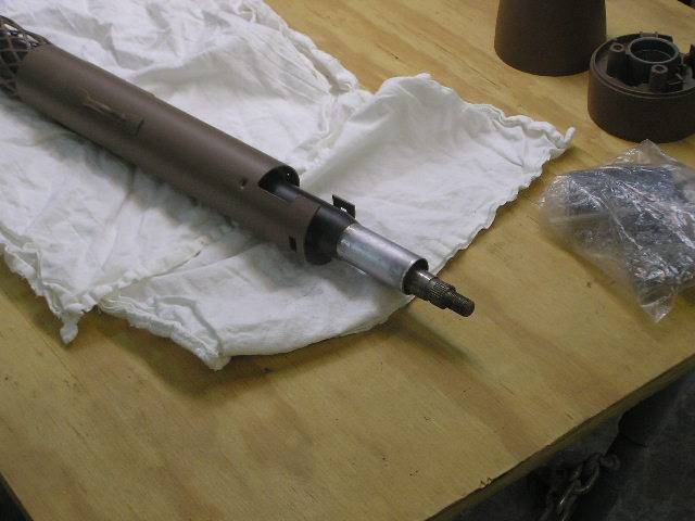

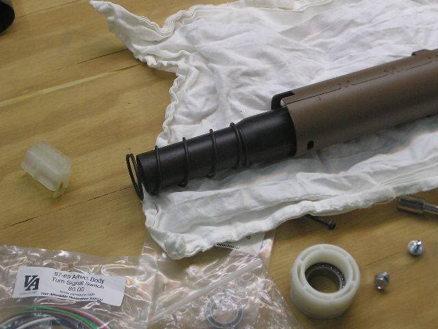

I then inserted the tube into the column and slid the spring over the end
next I slid the lower bearing on and bolted it up

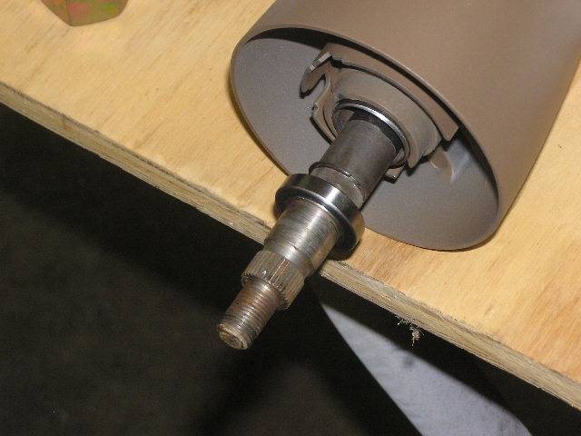

Next I inserted the shaft. Don't do it like I did or you will have to unbolt the lower bearing and slide it over the shaft and then re-bolt it to the column (because of the drive dogs on the shaft)

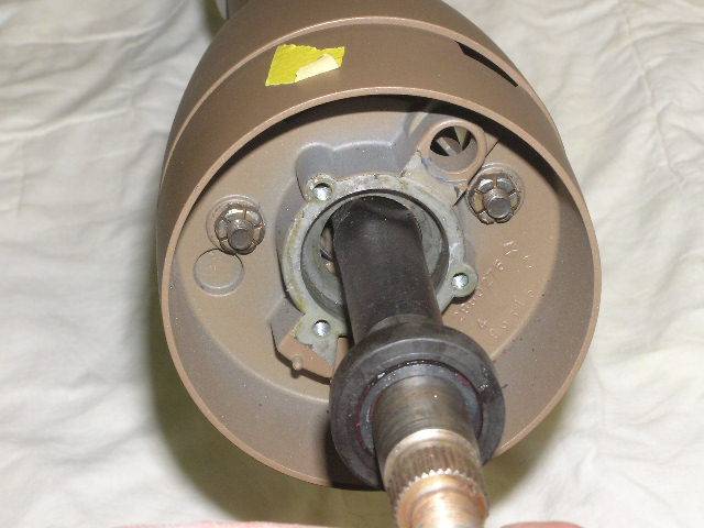

First the lower collar goes on
then the upper

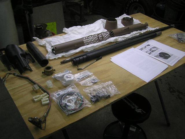

here are the parts we need to assemble

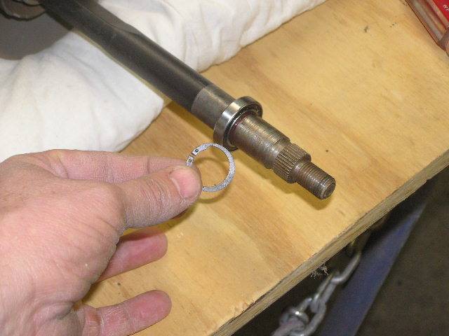

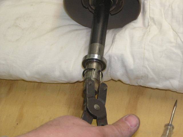

start with the c-clip (this helps to prevent the upper bearing from going to far)

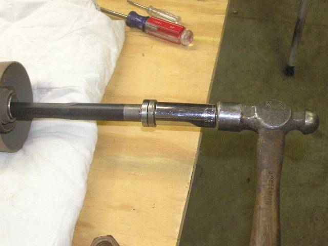

next I carefully tapped the bearing into place.
In this pic I used the old bearing against the new bearing along with a deep well socket, this way I was pushing on the inner race.

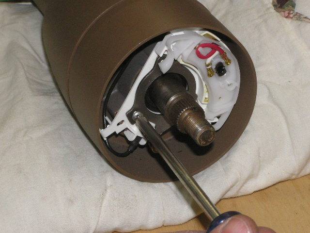

next is the upper retaining clip
then the bearing insulator goes on over the bearing
next is the hardest part! bolting the collars together. This may take a lot of trial and error to get it right

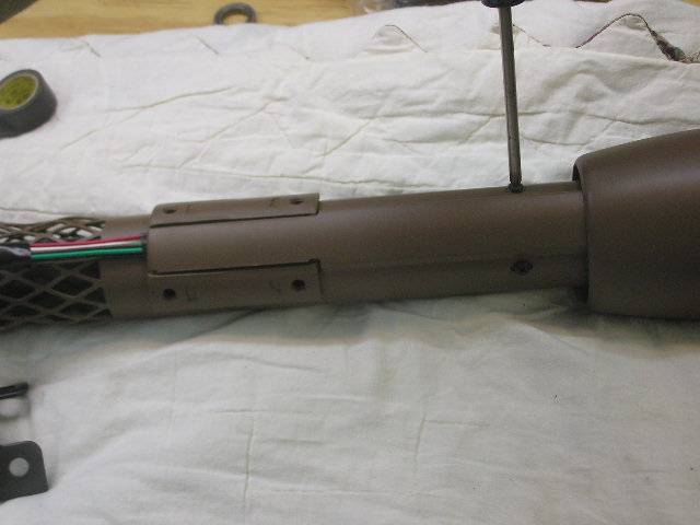

then the turn signal switch goes in held by the retainer

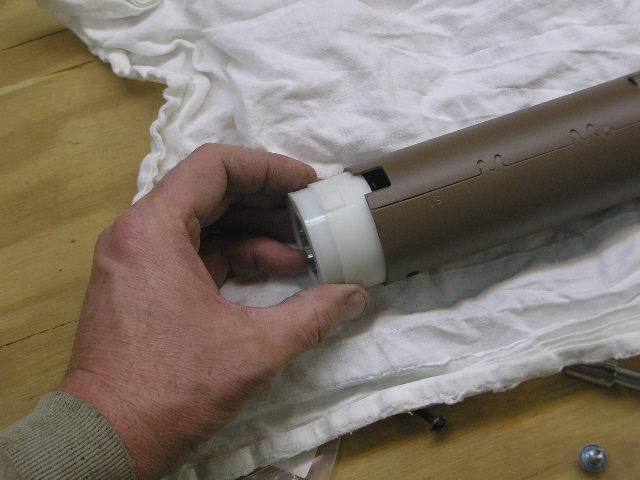

next I put the wire cover on
and the lower black plastic cover
