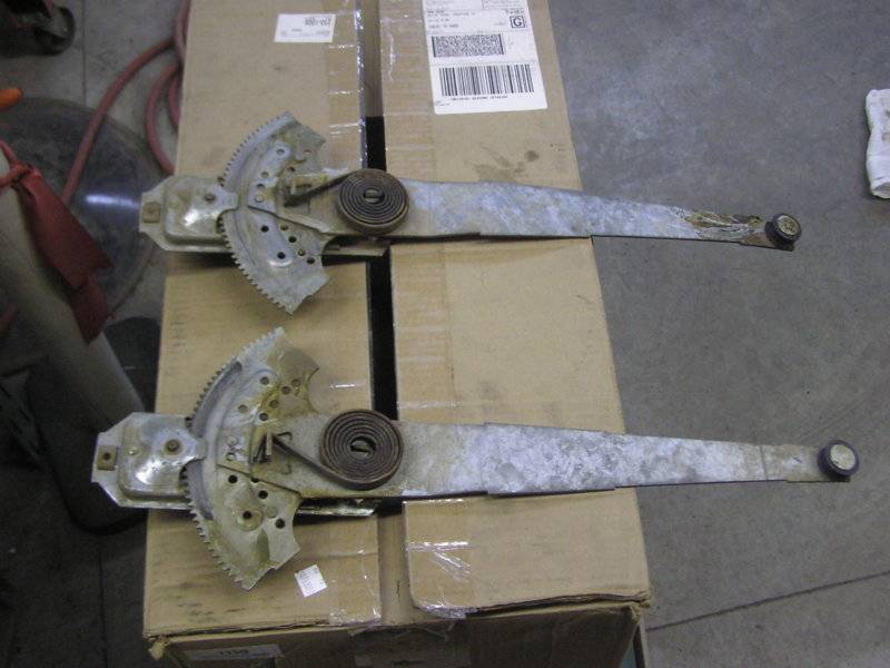

Your resto thread brings back fond? memories of my Coronet resto. Although I didn't take the window regulator apart. I see you took the spring off - how far into the regulator did you go?
I took it apart and cleaned it up the same way as the other parts. I just don't have a picture of it finished. I do have one showing the regulator taking a bath in Evaporust.

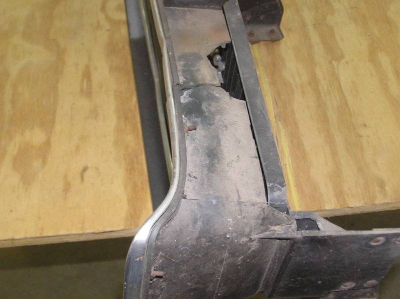

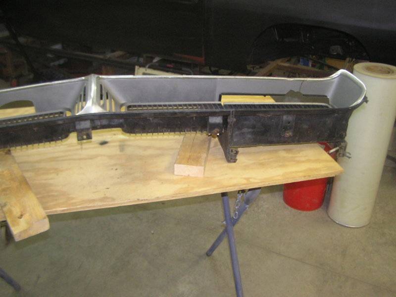

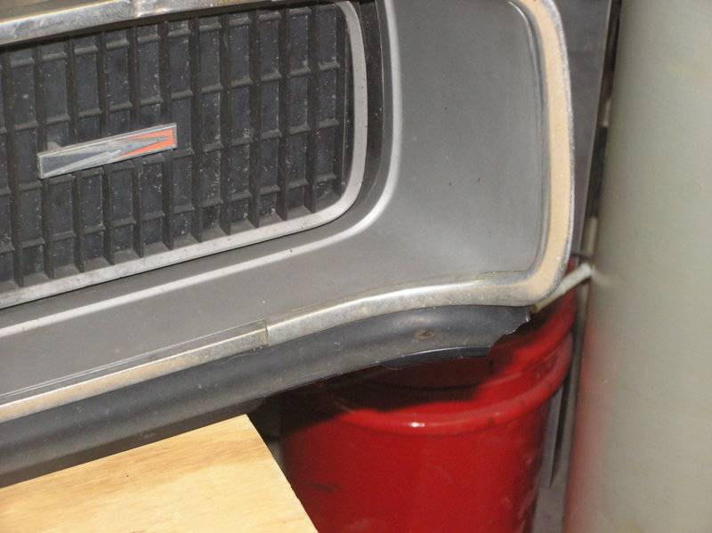

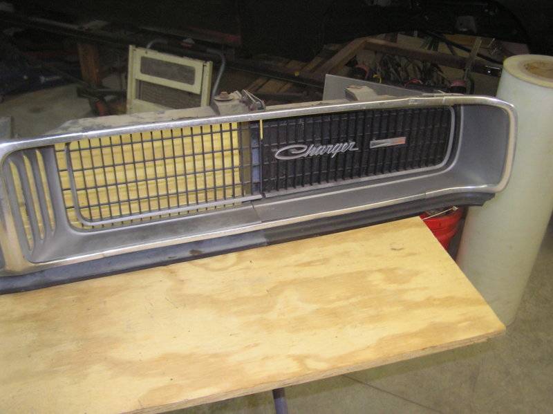

I started the tear down and restoration of my grill. This is what I started with.
Looks good from 40 feet, but it has some problems that need fixing.

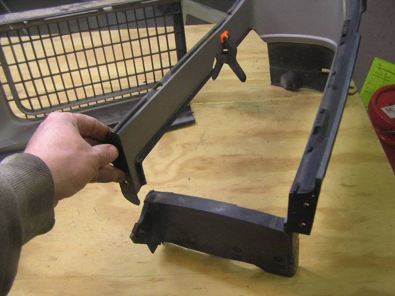

more....

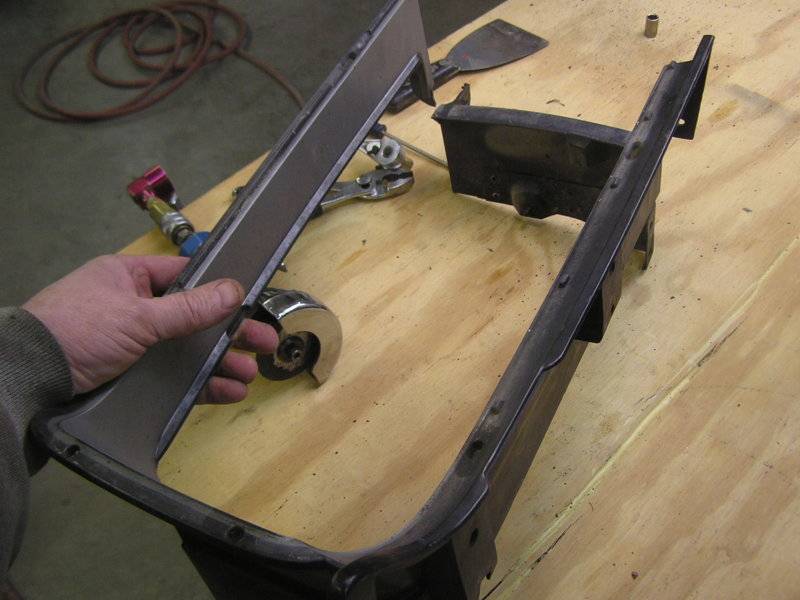

I have an extra set of doors, but as you can see, the drivers side stops are broken off. From what I understand this is a common problem. Apparently with the weight of the badges its to much and eventually they break off.
Looks like your grill has all of the same common broken and stressed spots that my grill had. I used several grills to gather the parts for my grill and then rebuilt the parts grills and sold them to make up for some on my costs. Your grill is in better condition than mine was and all there and fixable. I'm sure you will do a good job.

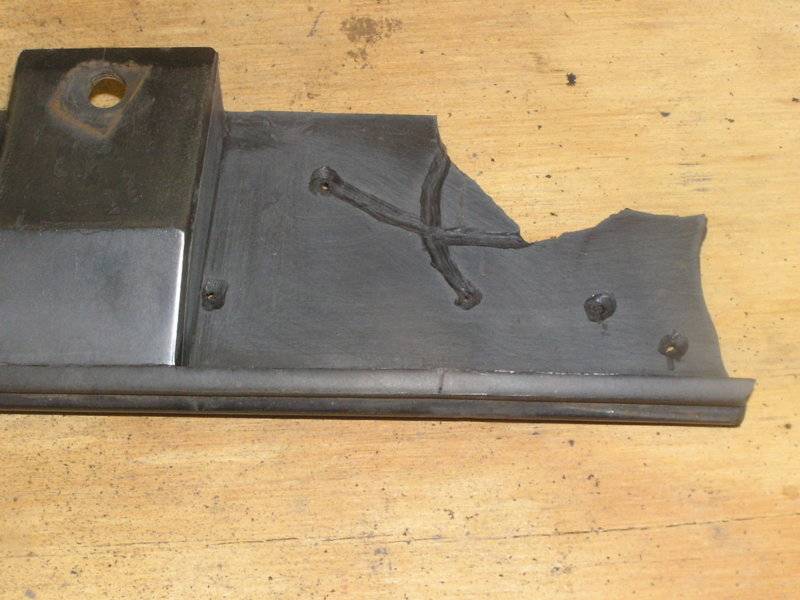

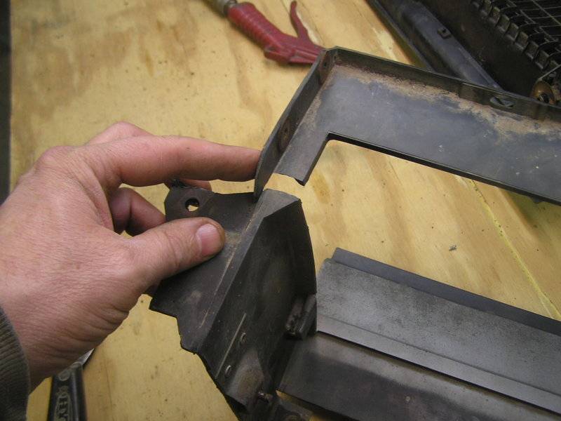

Here is a pic of the pass side bucket and where it broke
So my plan was to prep all of the plastic pieces (I used a dremel to 45 all edges and crack lines. I also drilled a hole at the end of the crack. This will stop the crack from continuing) and then to create a slurry using ABS shavings and acetone. Then using the slurry to fill in all of the cracks and holes.
