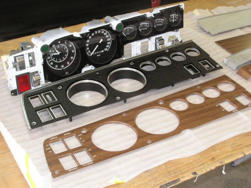

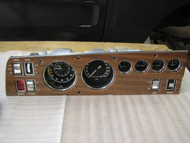

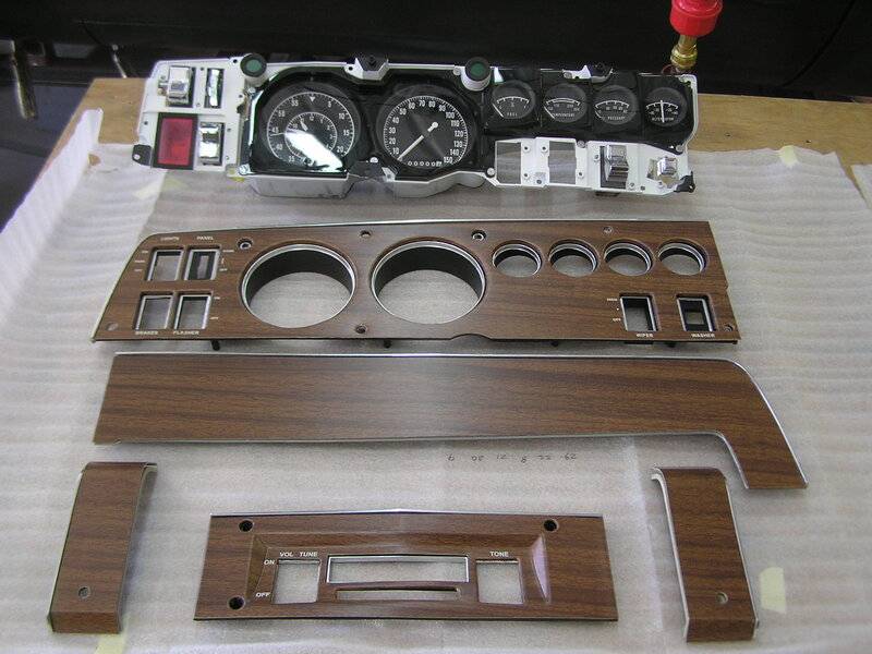

So here is the cluster completely assembled and the bezel and the woodgrain overlay

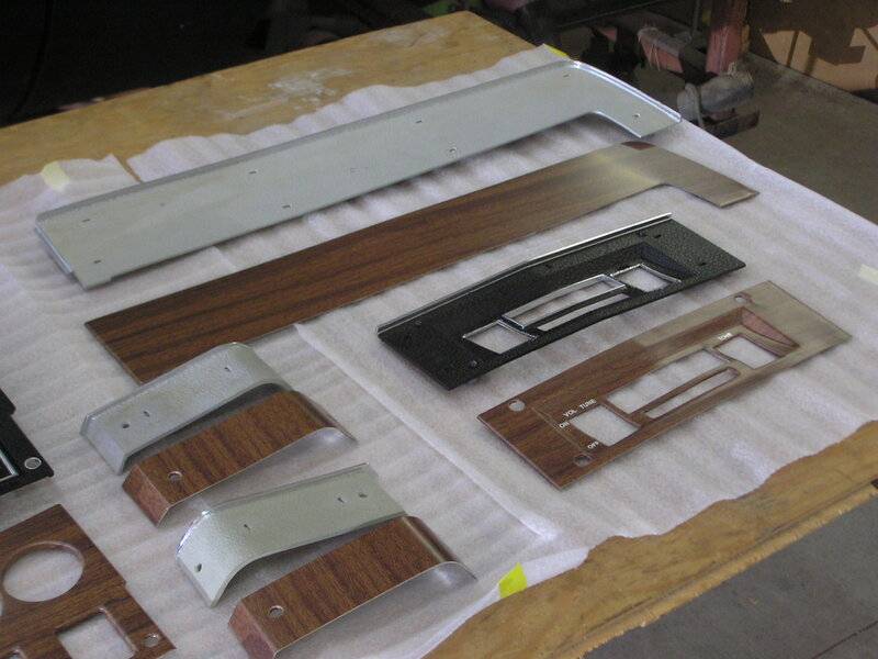

And the cluster assembly with the woodgrain overlays assembled into there
respective bezels
And the completed cluster assembly

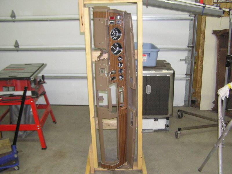

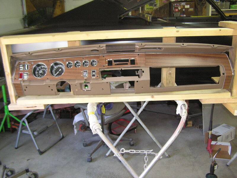

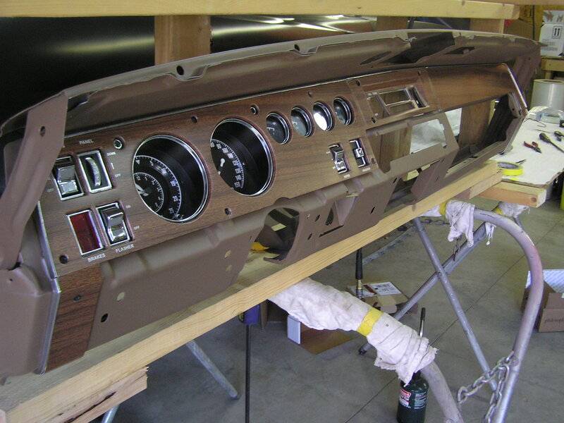

Here are a few pics with the cluster and bezels installed into the dash frame

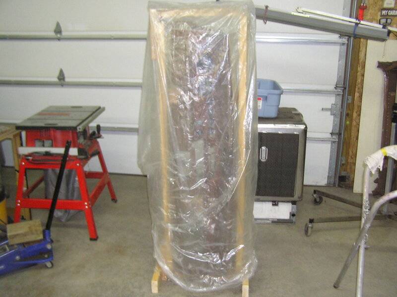

And here the dash frame is back into its storage frame and wrapped up for safe keeping
this looks fantastic!! What are the wood grain overlays made of? Are they wood? I want to add them to my non wood dash. Thank you

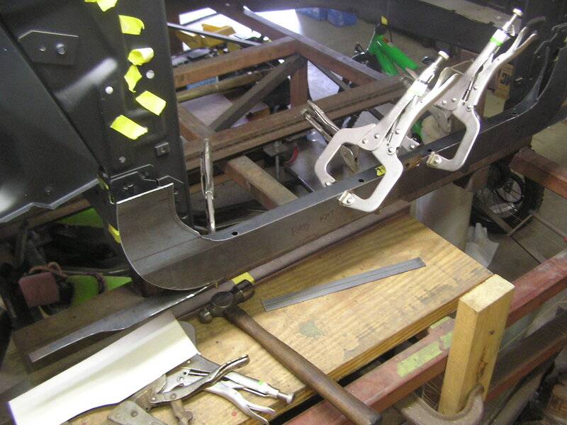

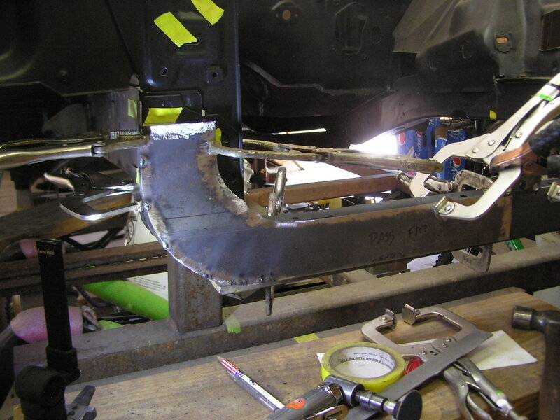

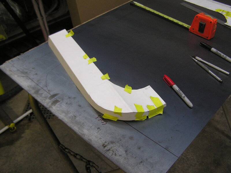

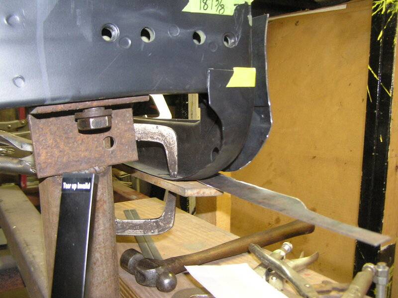

So I was originally going to buy a core support stiffener but decided to make my own. I really got the idea from b5cuda. It basically boxes the core support.

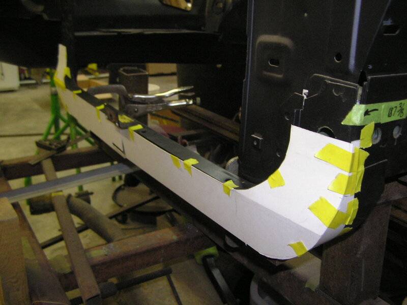

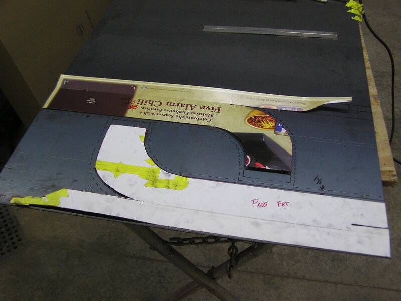

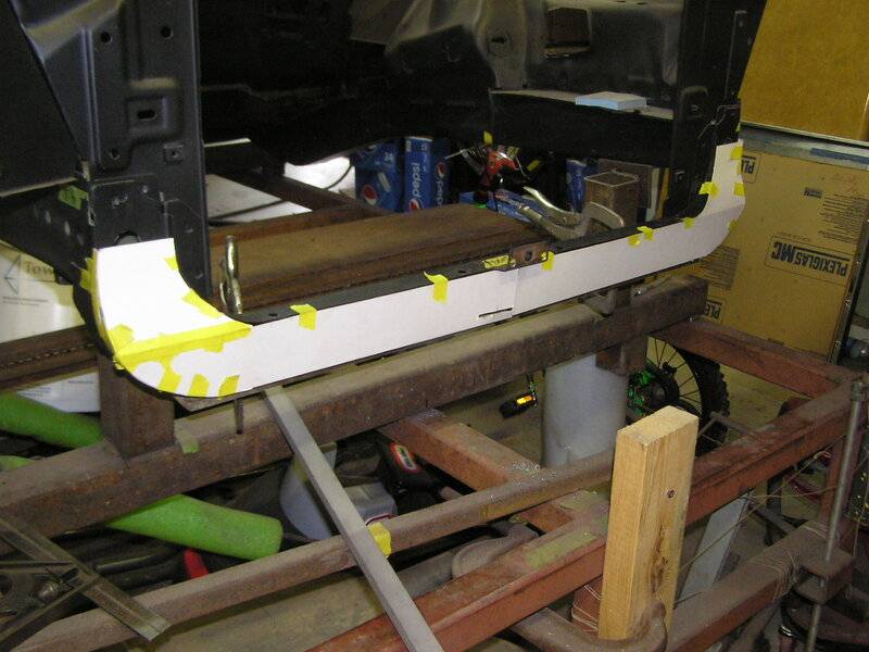

I started off by making a template in two pieces

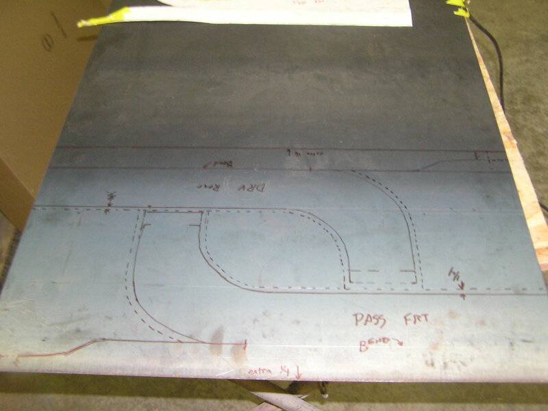

Then I transferred it to 16 gauge (.060).

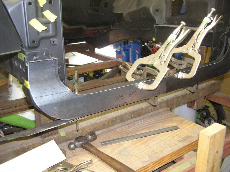

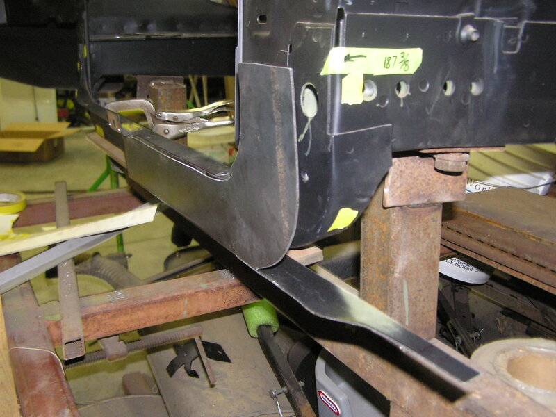

Here is a good pic showing how it will get boxed

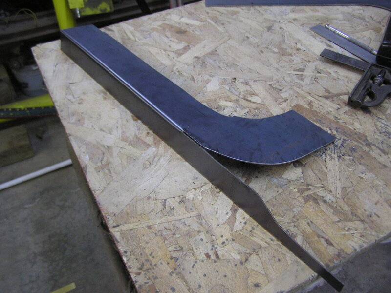

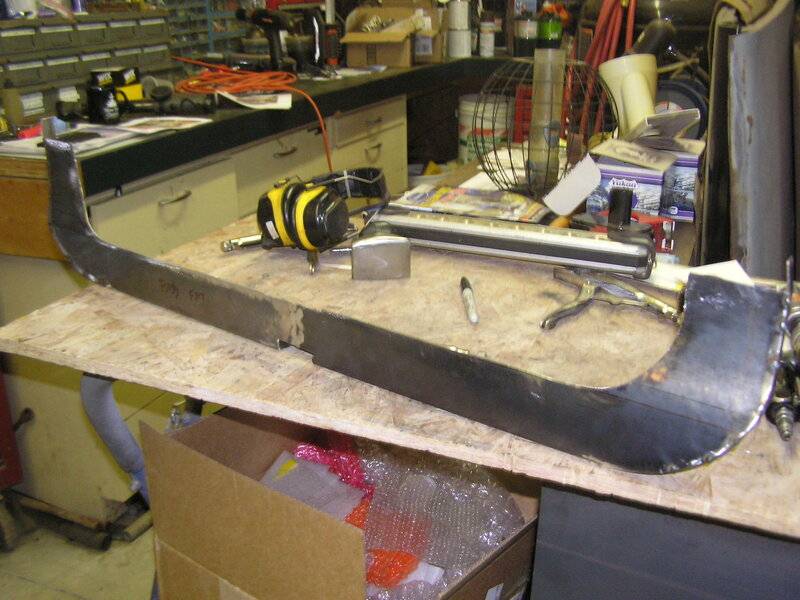

Here you can see the result of rolling the edge
(just to the left of the left clamp and above the hammer) (I used a big pipe)

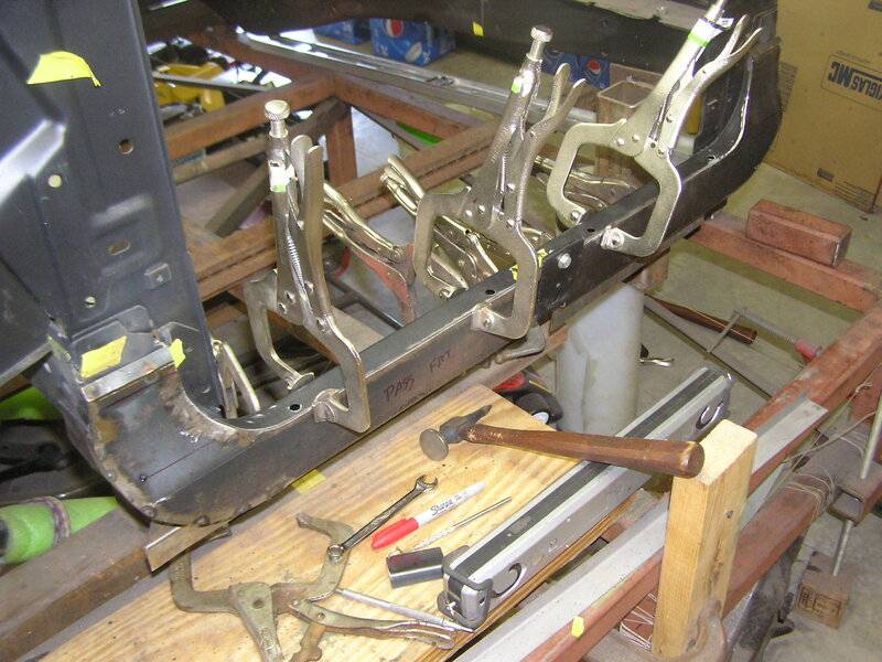

next I had to pull the side strap up and tack it
So I did the drivers side the same way then joined them
Here it is all mocked up

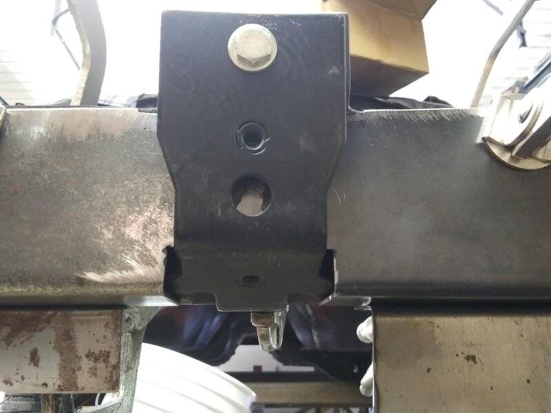

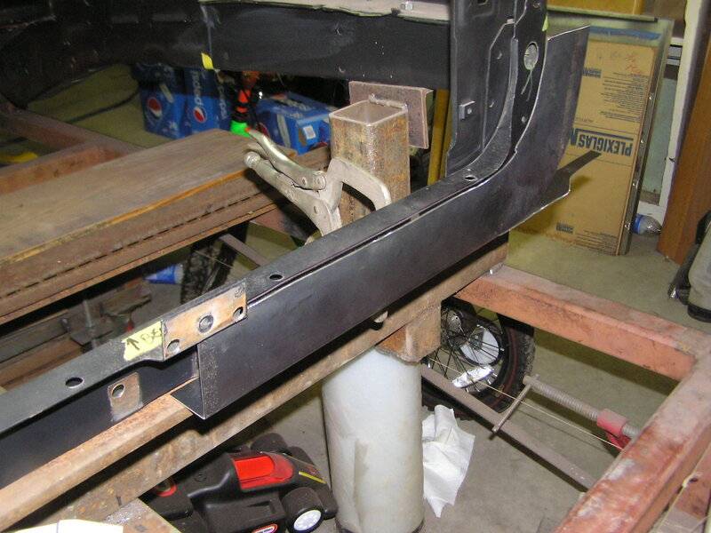

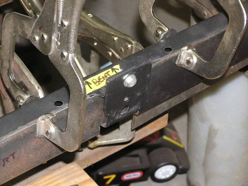

If you noticed in the previous pics I notched out for the grill support bracket.
I didn't like the way this looked. So I filled in the box and sliced the
bracket off right where it would intersect the box and welded it along the bottom
