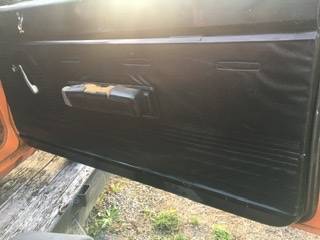

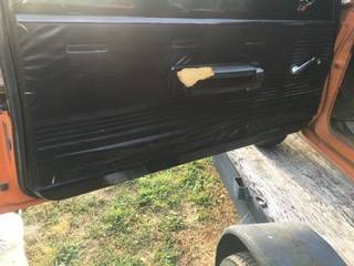

Hi guys, attached is a pic of the door cards on my 70 RR, the sales brochures and re-pops don’t seem to show this pattern, what’s the scoop fellas
They have the small rectangular patterns above the armrest
Look through all the 68-70 door cards Plymouth and Dodge at the Legendary site. They will all interchange. You will find a match as to what they are. You can also buy the correct ones if that is what you want.

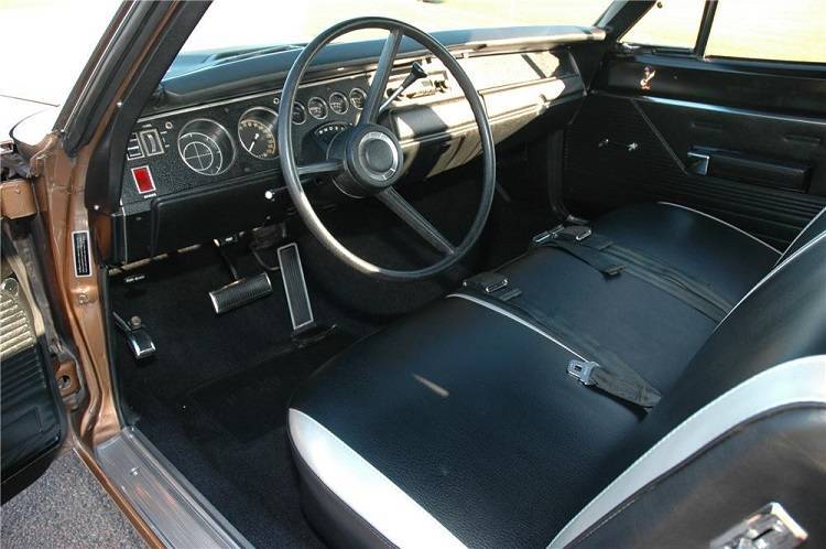

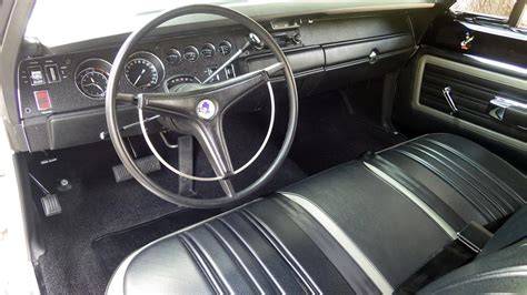

You have the basic door panel and seats. It’s not for sale anywhere. Code is M2X9. Top photo is what the seat looks like, the second Photo is in the car
The one shown on legendary website is the deluxe bench seat interior. Code is H2X9 Bottom 2 photos show the seat and door panels
7341975A-BA86-4AE9-B56A-A66BFB19A415.jpeg View attachment 1000840 View attachment 1000841 58141800-5ACE-4087-831C-4D7716230040.jpeg 359B27F7-F6A3-4AA2-AB8F-296888B69BB5.jpeg B9A15A1E-5629-4933-BB48-DA5BC5EFBECD.jpeg
