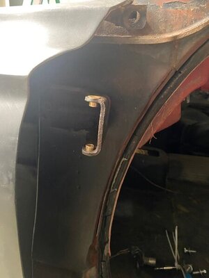

Working on my '64 and my doors are sagging. I got the door hinge kit from Joe Suchy and I attempted to put the bushings on over the weekend. When I finished installing the bushing I tried to put the door half of the hinge on and it would not slide in. It would bump into the shoulder of the bushing. Attached is a picture of the driver's side upper hinge. Did I install the bushings upside down or do I need to file down part of the hinge? Thank you in advance.
Unless there is a major difference in hinge design on later b-body,s 66up then you need to remove the fender and door part of the hinge and assemble them then press the new bushing into both while assembled.
Taking the fender on and off is no problem. Pressing the bushing into both sounds reasonable. Where I am getting confused is where does the shoulder for the bushing go? On the body half of the hinge or the door half of the hinge?
Its been awhile since I did mine but I went out and double checked them just now. With the hinge assembled the bushings both press downward to join the two hinge sections. What I did was assemble the hinge, press the lower bushing in first so the the shoulder will be on the inside of the door hinge and then the top one, the shoulder is on the fender side of the hinge.
I think I understand. Let me see if I got this straight. On the photo I posted: The lower brass bushing is upside down so I need to remove it and flip it around so the shoulder rests on the fender hinge. The upper brass bushing needs to be removed from the fender hinge and placed on the door hinge with the shoulder on top of the door hinge with the rest of the bushing sliding into the fender hinge.
So in an attempt to show you I went to grab a picture and what I did worked but looks like this may be the proper method. As in this reproduction hinge you can see the bushings are pushed into the frame side of the hinge only like you have. Most likey they just grind away enough or press the two hinges together in a vise to gain the clearance for the shoulder. I think I had the same issue you are having so I went top bushing through the frame and door hinge and lower just through the frame hinge as shown here.
