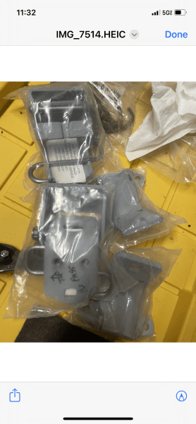

Lots of threads on this. Don't try it. Send them to the guy.
I sent my 67 hinges to MoparLeo and they came back very nice.
