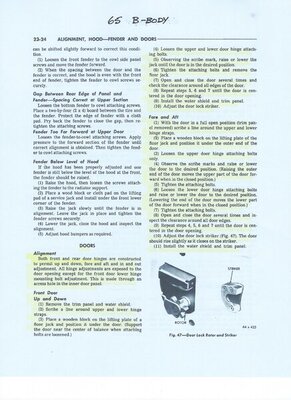

Here is a reprint from the Factory Service Manual. 65 B-BODY DOOR INSTALL 1.jpg 65 B-BODY DOOR INSTALL 2.jpg 65 B-BODY DOOR INSTALL 3.jpg
  • DOOR REPLACEMENT.pdf
  • DOOR ALIGNMENT 1.pdf

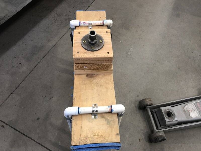

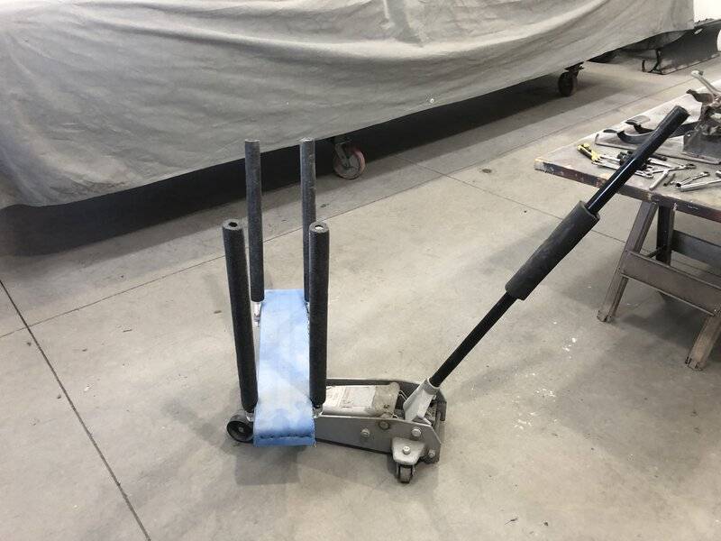

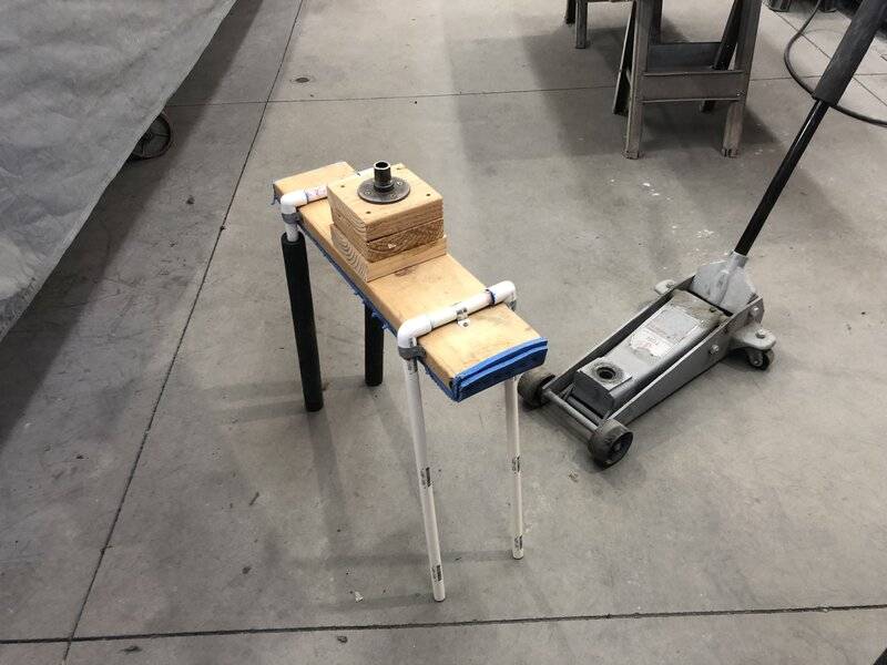

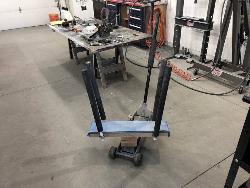

Or make a door holder that fits on a floor jack designed after the ones you see on-line. Made mine out of 2X6s, PVC and foam padding. Works great. Still a 2 man job though.
Let me know if you're interested and I'll dig it out of the attic and take some pics.
Thanks for the offer of the pics. They may help the OP with his install.
Here you go. Cost about 1 hour of my time. All made from leftover materials laying around the shop. Not pretty but works good. The PVC flexes and squeezes just the right amount to hold the door.
