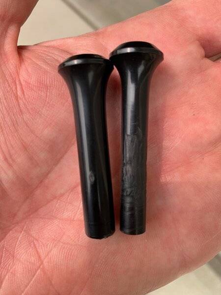

Purchased reproduction door lock knobs from OER through Classic Industries. Original on right and the reproduction on left. Too big on the outer diameter to fit down (through) the ferrule hole. Product number MD700 for 64-74 Mopar A & B-body. I wish they wouldn't even sell them if they can't make it the right size.

Did you buy the Door lock Ferrules MD101?? I did and they fit perfectly with the knobs
I have the ferrules installed. The knob is too large (wide) as per the picture and absolutely will not fit down (into) the ferrule
I should correctly answer your question. I did not buy the reproduction ferrule. I have the cars original ferrule and lock knobs.

The repop ferrules are made for those knobs. That’s probably why mine fit.
The repop ferrules are made for those knobs. That’s probably why mine fit.[/QUOTE
I wonder if I'll have to buy their reproduction door, and reproduction hinges to go with their reproduction ferrule, so that their reproduction plastic lock knob fits. Geeesh. Thanks tons for the reply.
Lol no worries, mine fit on the original doors. And given that AMD makes all the sheet metal.. lol
I had the same problem with the diameter to large and got the new ferrules also, still no good. I ordered some straight chrome ones from flea-bay that we much smaller diameter. They look better anyway.

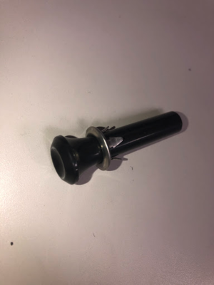

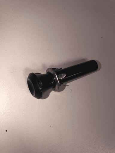

Classic Industries wrote me back and said, " Good Afternoon Mark,
We have seen some cars that have needed the MD101 (ferrules) to be purchased because theirs is (a) small(er) ferrule then the MD700 (lock knob can fit into). We believe it might be different factories or times of the year (that made the ferrules and lock knobs I'm assuming they mean). We do know the MD700 and MD101 work together." And they provided a picture. I do appreciate that they replied.
