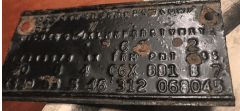

Tried using the Google searched door tag decoders on this with little info. First, is there a good online decoder? Second, can I please get some assistance on this one? Guy claims CA car, original paint, original engine/trans/etc and out of 30 yr storage 1968 Charger R/T. Car is ~2hrs away. Picture is partially fuzzy but if legit, likely something to jump on at the right price.

Well, try searching fender tag decoder... But here is what I got. The actual assembly plant would be in the VIN I do believe. The fender tag is just options.
CAR: Dodge Charger R/T 2 Door Sports Hardtop
ENGINE: 440cid 4-bbl HP V8
TRANSMISSION: 3-Speed Automatic
TIRES: F70x14 White Side Wall, steel belted
BUILD DATE: March 12.
AXLE: 3.23 Rear Axle Ratio
INTERIOR: Charger Trim Grade, Vinyl Bucket Seats. Black Interior.
PAINT: Monotone Black Paint.
OTHER: Black Upper Door Frame Color. White Bumble-Bee Sport Stripe.
MOLDINGS:
25: Drip Rail Mouldings
30: Body Belt Mouldings
78: Wheel Lip Mouldings
ABC OPTIONS:
P6: Rear Seat Speaker
R1: AM Radio
X2: Tinted Windshield Only
abc OPTIONS:
h7: Fender or Hood Mounted Turn Signal Indicators
