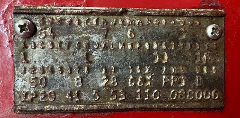

Hey,
so far I am doing good with my 68 Charger. Unfortunatley I am a little stuck on the decoding of my fender tag, especially on the accessories, especially wether the gear ratio is right.

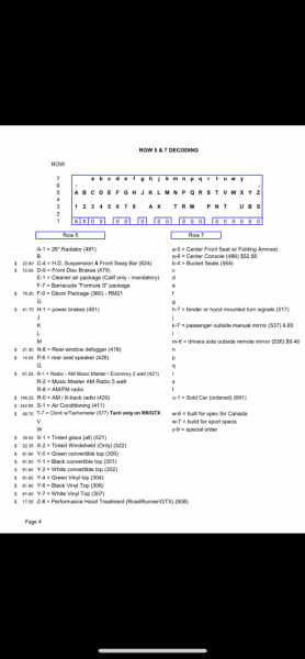

You need to make sure the characters are under the correct letters or the decoder will return "Unknown Option"
Here is the decode I did, your tag is horrendous for clarity but I think I got everything, except the tire code.

Thanks a lot for the help!! I agree, really horrendous tag. But original and still there :)
@Don: Awesome! Thats it!
Chris,
If you go to the top of this page, click on Forums
Scroll down to "1968 - 1970 Mopars"
at the top is what are called :"stickys" in yellow background
There is a link I created called "Something to help decode your VIN and Fender Tag 1968 ONLY"
That is the original document that Mr. Belvedere attached.
The B under "U: in the second line from the bottom is
"Upper Door Frame Color - Black
BTW the code for your tires "53" is
8.25 x 14
White Wall
2 - 4 ply
Steel Belted tires
