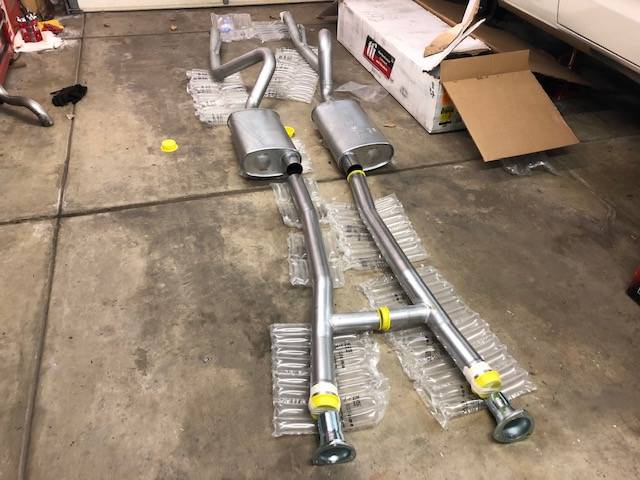

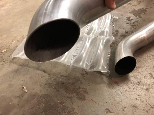

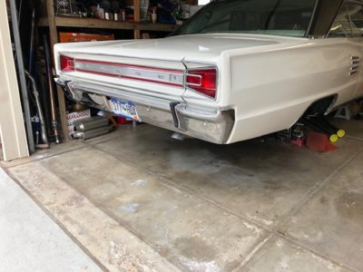

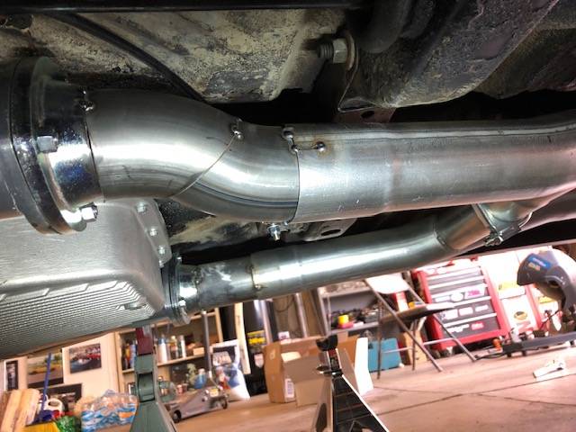

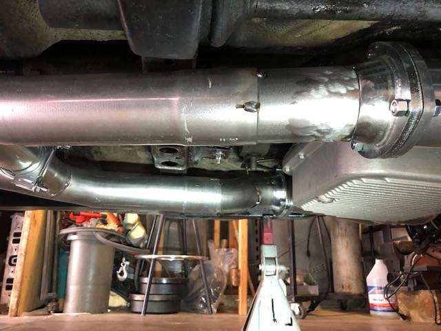

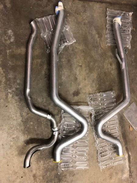

I got a tti 3 inch exhaust kit this week. Sorry about the filthy garage floor, it’s where my wife parks her Jeep. The 106 lb box was packaged very nice, with lots of bubble wrap. I’ll post pics as I go, there is already a couple small contact points I’ll have to address, no big deal. And I’ll need to make the adaptors to hook up to the H pipe. Doug’s 2 inch, 3 1/2 collector. The tailpipe on the left is the 2 1/4 accurateltd pipe that was on the car.

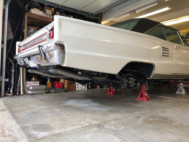

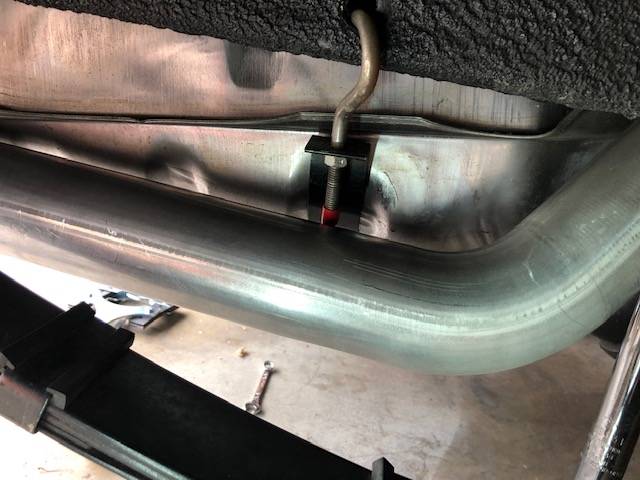

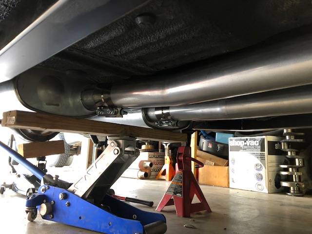

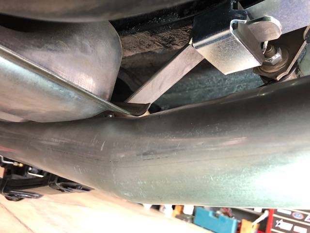

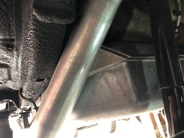

All 4 corners of the gas tank need the points bent up. The hook that holds the gas tank strap needed to be shortened. Overall it’s going together pretty good. I probably won’t get to the header to H pipe adaptors/reducers until next weekend. Be safe!

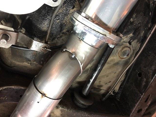

I made the adaptor/reducers today and will finish welding tomorrow. Came out pretty good. Passenger side was pretty straight. Drivers side not so much.
