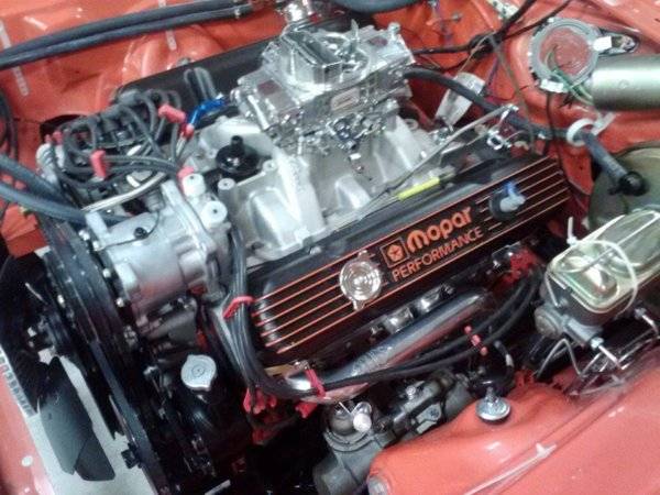

How well do Doug's fit with a 383 and power steering on a 69 B body?
Is this with a 883 trans? Or is it a 727? I am currently attempting to put in the same headers, 68 Coronet, 440, 883 trans. PS, Wilwood master and a southwest booster. IT is VERY tight, I know I cannot come through the top. So the bottom it is....question, do I need to jack the motor as well?
Thank you. I have the clutch lever in the way, I'll try to see if I can work around it...I don't think I can install the lever after the manifold.My car, 727. Yes, I too came up from the bottom and really, no issues at all. No, I didn't have to jack the motor up neither. The hardest part was angling the whole header up through my torsion bar to the engine bay. One of the easiest. Good luck
