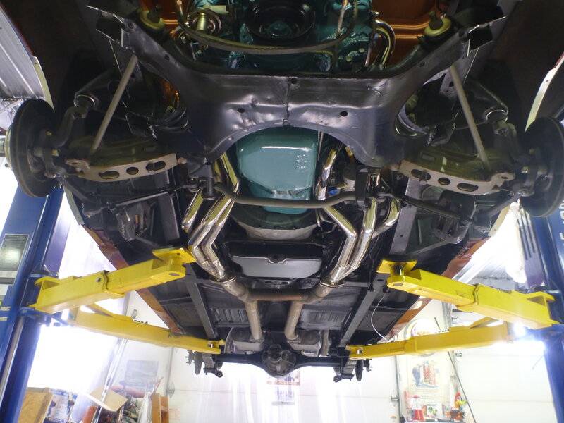

TTI's on the SBx340 Dart.. neither brace can be left in place..
