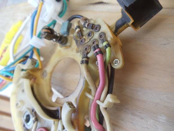

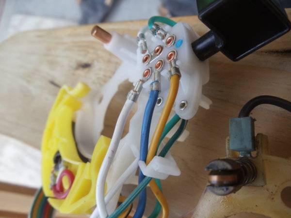

I am replacing the turn signal switch in my '72 SSP project car today. The spring loaded horn contact in the switch I am removing had a clever little round wheel, which I was impressed with. The replacement switch only has a spring loaded pin. Tried to swap the two, but I don't think so. See first two fotos below:
The wires colors won't matter, as long as the terminals match up, but I wonder why only two of the colored wires on the new switch match the colored wires on the old switch (red, white). I wonder what went wrong there? Maybe the old switch was not original to the vehicle?

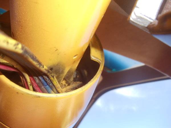

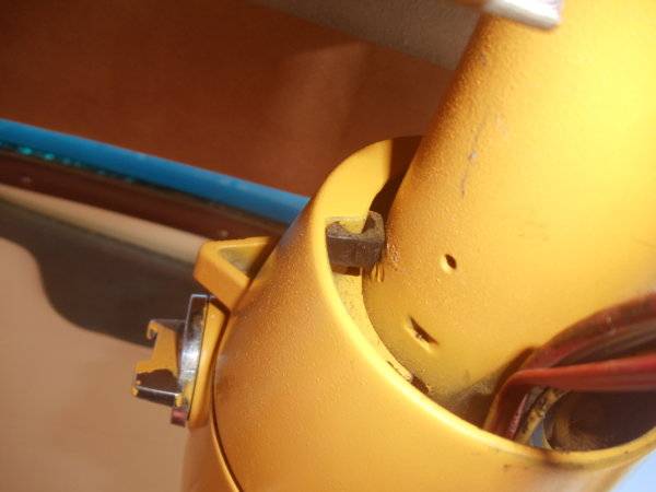

While I was working on the steering column, I noticed for the first time a tiny rubber bumper on the rotating steering lock part of the column. It seems to be there as an anti-rattle device. The bumper is on the passenger side and there is no bumper on the driver's side. I wonder if there originally were two installed from the factory? Anyway, I had never seen this rubber bumper(s) before personally, and never saw them mentioned on a forum, so I thought I would mention it (them). See second two fotos below:
