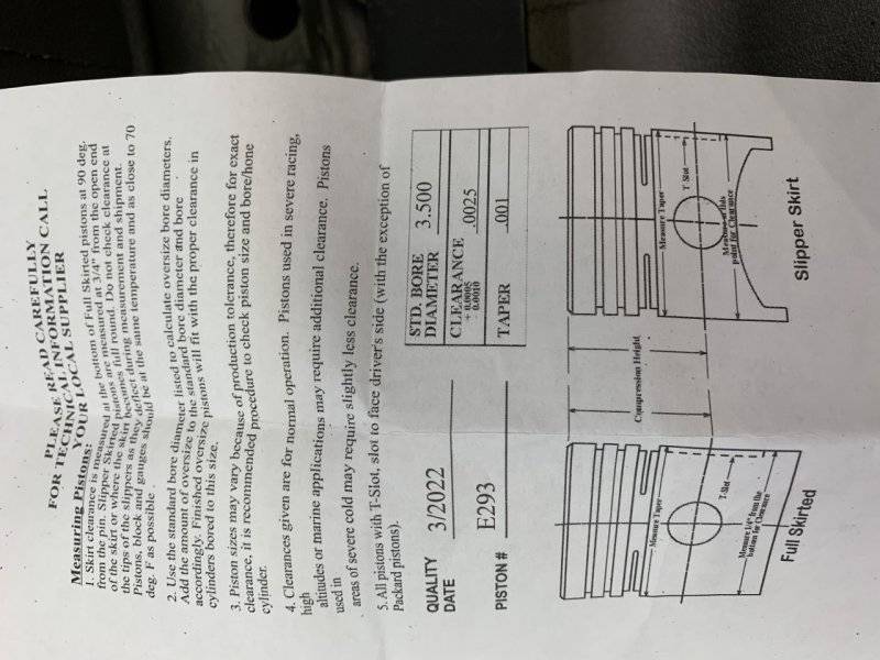

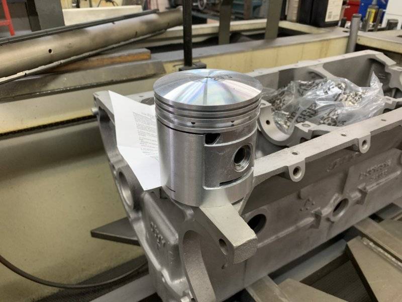

Hopefully, not to jynx myself, I have installed a dozen or two over the years, and have not had any problems. They do usually require more clearance than most people would like on a cast piston, ~0.0025", and who knows if some shops even read the install specs. The last set I used were a '55 Hemi set I put into a '54 (ups compression an "RCH") and are running great.
These are for a '39 GM 216 6cyl...
