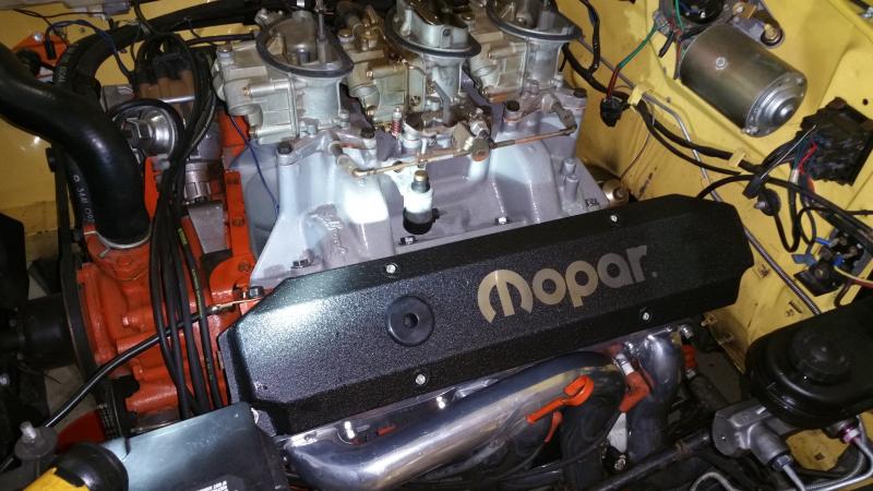

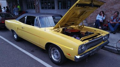

71 440 stock configuration unknown (only stamp is an upside down A on the pad by the distributor) flat top valve relief pistons, 78 heads that appear stock, Comp Cams springs, locks, and retainers. Purple Stripe cam (unknown which one, sounds healthy-I am guessing it's the 284 and not the 292) Comp Cams hydraulic lifters, TTi 7/8" primary tube headers, Doug's (awesome) electronic cutouts. Chrysler/Edelbrock aluminum 6 bbl intake and I recently rebuilt the center carb with #65 or 66 jets I don't remember, I would have to look them up. Runs great! I shift around 6k.
I've been eyeing up the Doug's cutouts for sometime then I read a bunch of bad reviews saying the motors are too weak and they don't always open... good to hear you like yours! I still think about doing it
Nice 70RR!, from what I can see! Got any pics or vids a little closer? lol.. My last one was yellow w/black, 4spd, identical to yours. The first cheapest and easiest thing I'd do is just get some tires. Bet you'd gain at least a second without all that spinning and pedaling.
I have only had the Doug's cutouts since October, but I got them because of their unique "guillotine" design. They don't leak at all, are "self cleaning" by design, and when open have absolutely NO obstruction in the exhaust path. Fantastic!
I was expecting to be in the 12s in the 1/4 mile, but with all the wheelspin, 13.9 at 102 was my best run that day. I'm sure my 60 ft times were horrible. I put Nitto drag radials on a 89 Conquest TSi I had tweaked and it ran 14.35 at 97, so I am sure that you are right-I should be able to take at least a second off if I can hook and roll.
Beautiful! Identical to mine except I didn't have the dust stripe on the side. Got it around 1977 for $400. I had to put a used front cap on it when I bought it, and ended up painting the whole car flat black. Ran low 12s, could have went a lot quicker if I knew then what I know now.

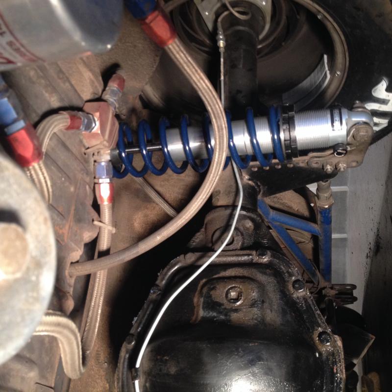

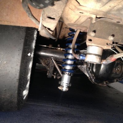

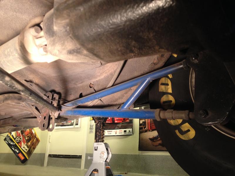

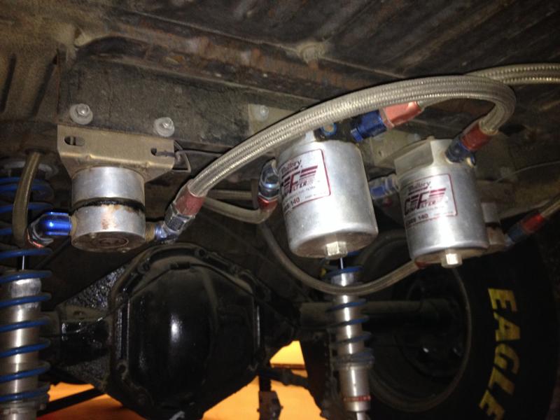

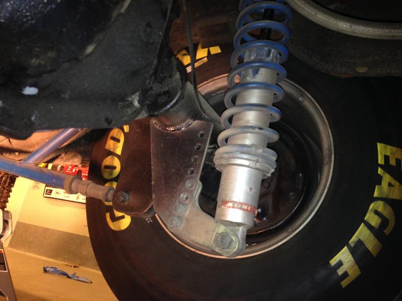

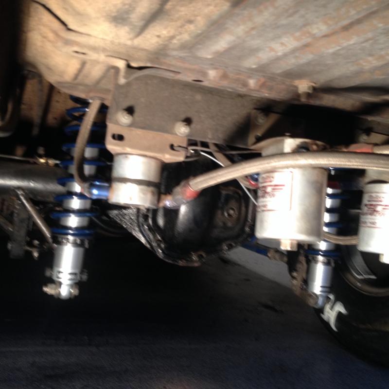

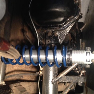

IMG_0395.jpgsome newIMG_0396.jpgIMG_0397.jpgIMG_0398.jpg pics of the rear shocks Strange and new tires. The other pics are the old Konis and my old Goodyears

Cool old pic of the Roadrunner. Thanks for the suspension pics, those are ladder bars? and what happened to the leaf springs? I assume the springs on the shocks (struts?) support the weight?
all done with coil overs shocks and ladder bars. this is strickly drag race car.

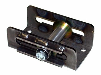

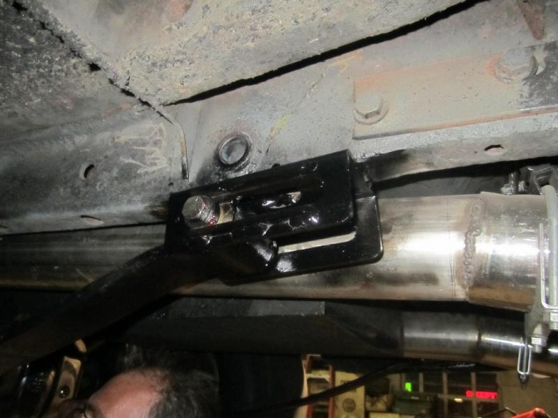

Picture shown is the afco slider that does not come with the hardware to fit caltracs.If you have caltracs,buy their slider or you will have to buy the hardware from caltrac,,,,,,,,,how do I know,,,,,,,,,,,,,,
