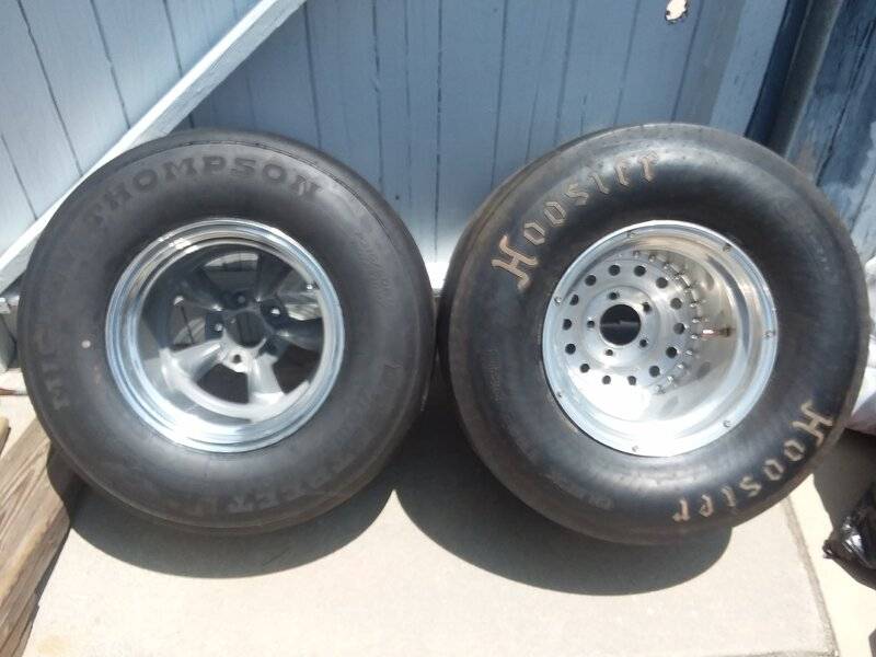

I've got a pair of the 315 pro's, but I haven't tried them yet, the car isn't ready. I also have some giant Hoosier bias QTP's, but I don't know which works better. Both have dot, but the mickeys say in big letters, not for highway use. The qtp are street legal.

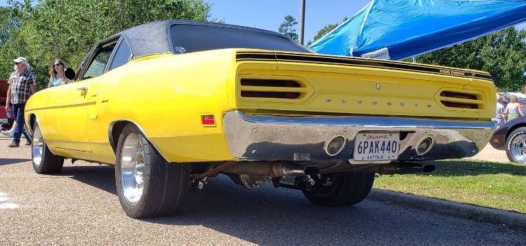

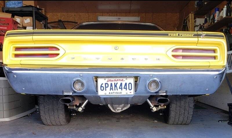

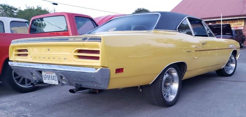

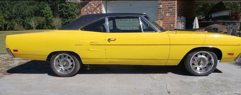

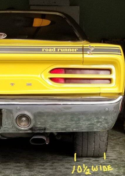

I had Nitto 555R drag radials on my 89 Conquest TSi and they were a few months old, great tread. I was driving from south Louisiana to Atlanta for a Starion/Conquest meet. On a great blacktop highway, Interstate, not the kind with those goose **** slick pebbles in it, so a good surface. 75 mph took it down to 60 when the medium light rain started. 10 minutes later, on a straight as an arrow stretch, the *** end suddenly had a mind of its own. It kicked out right, left, and right, with me doing what I could as a very experienced driver, having done power slides, doughnuts, brake slides, etc since I was 16, and I was in my 40s when I had the TSi.
Wound up in the tall grass between the two highways, no drop-off, no culvert or trees etc. I was able to drive out and other than a lot of grass on my car and a butt pucker that lasted an hour after, no damage, BUT IT COULD HAVE been very different and deadly! They worked well at the track, but I'll never own them again.
NOW on my 70 Roadrunner, when I installed the 9" W x 17" diameter w/5" backspace Year One aluminum Rallye wheels, I took a guess at what would fit and got a pair of Toyo Proxes TQ drag radials in 315/35/17 size. They fit like they could have been factory equipment! NO rubbing anywhere ever, good at the track from what I can tell, BUT I have a manual transmission and the line lock I had installed in late 2020 has never been used, so I have to see how they work with a little more heat in them other than the dry box clutch dump and spins I'd been limited to.
FOR ME, the MOST IMPORTANT THING was good, reliable rain performance, because although I try to NEVER drive or go to an event where rain is likely (I don't like my car to get wet) it happens...
NEVER one problem in the rain or on a wet surface, NEVER, and I'll need to replace them in this year, after over 3½ years of use!
OUTSTANDING TREAD PATTERN AND "VOID" to let the water find its way out.
If you crash, you know the range of consequences!
I am not beyond a street challenge every now and then, so their overall traction is important, but NOTHING is as important as wet surface performance. If that fails, well...
Here they are. If you are looking for a taller sidewall ratio, good luck, but I'll be getting another set of Toyo Proxes TQ drag radials, except I'm going to try the 345/40 size and see if they fit.

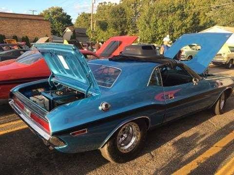

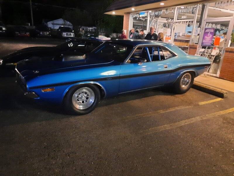

I run M/T Drag Radial Pro's on the street and strip. No issues at all and don't even wear out as fast as you would think. To say they are sticky and hook is an understatement. My brother was following behind me to a cruise night one night and when I change lanes in front of him he said I peeled the white line right up off the road when getting over a lane. Partial of the line was still on the tire when we got to the cruise night.

Thank you for the great feedback. That's what I wanted to know
How are they holding up? I just ordered a set of MT Street Pros to replace a worn set of Nitto 555Rs
