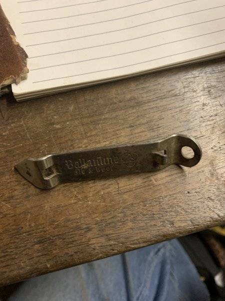

Found a tool to get the trim off pretty easy
Should I try this?
I was thinking on using a paint stir stick.
Any comment on what's best?
I used it yesterday, popped off easy and the tight ones needed a flat screwdriver on the end to help pry up. No scratches or dents, just go easy every 3-4” or so. Might dress the edges smooth and round them a little, then maybe use a thin feeler gage as a backer
THANK YOU!!!!! This works PERFECTLY!
