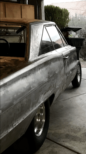

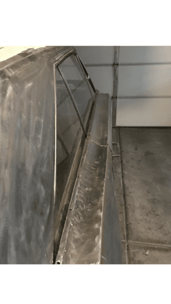

Not the best pics of my dip rails shaved and far from being completely massaged but i really like it with them gone
View attachment 529549 View attachment 529550 742A292F-C137-445B-A370-E1B3949185B5.png A81E5993-02C8-4C23-8231-81BBAC62F331.png

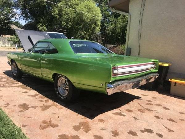

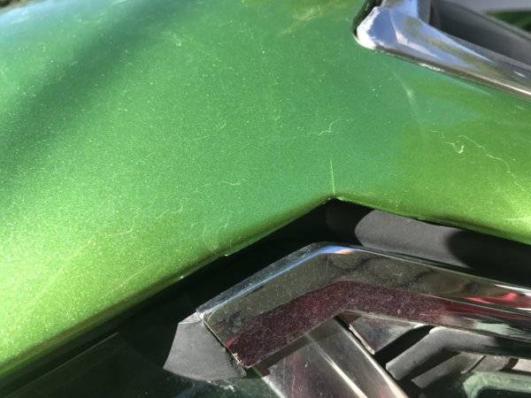

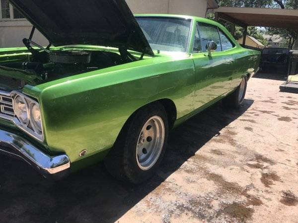

I shaved my drip rails as well on this 68' satillte I did about 2 years ago, first remove the upper trim molding that had the glass rubber in it then cut off wheel the drip rail weld body work, I actually glassed the window channel trim to the body makes a much cleaner appearance most people don't even notice till you point it out

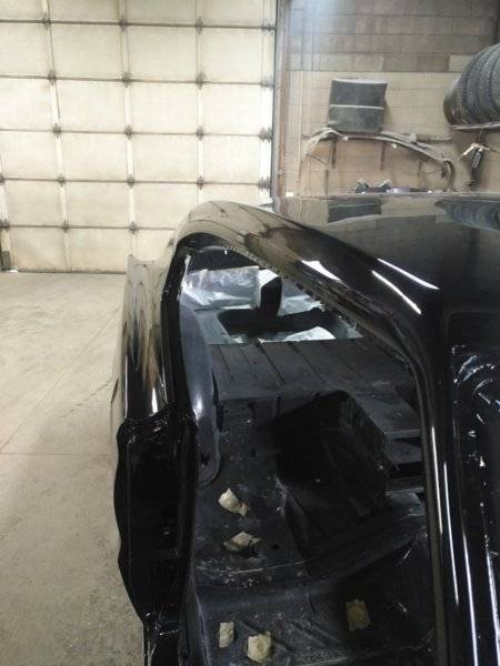

This is my 67 Charger. The PO removed the drip rails then abandoned the project.
I bought it and had my body shop finish it . I think it turned out great.
