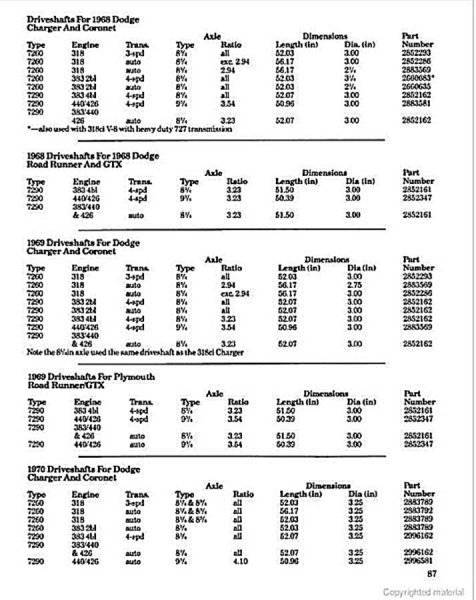

Would the length of the drive shaft on a 69 hemi Roadrunner be the same for a automatic and a 4 speed car or are they different lengths ?
Pretty sure they are different plus it depends on what differential is in the car. I would assume a Dana if it's a true Hemi car.
The internet is your friend. At the end of the day best practice would be to measure your particular set up and have one built to fit.
The chart shows 50.39 length for both 4 speed and auto! Same part number too. What a coincidence.
