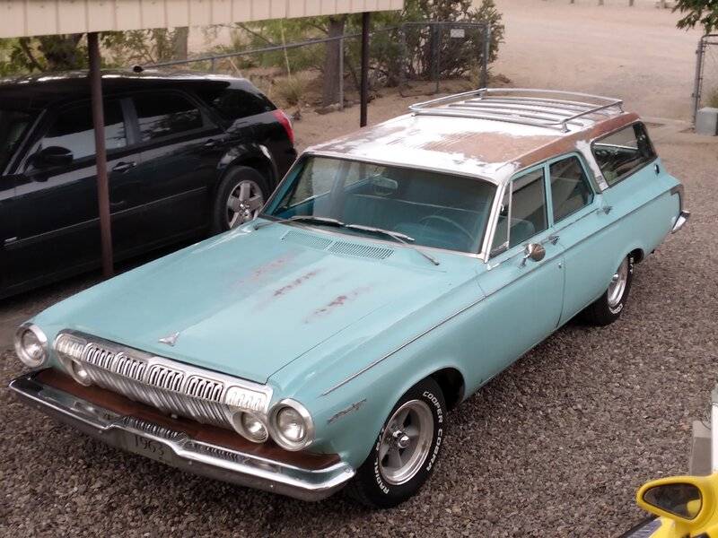

'63 Dodge 330 wagon with 727 and trunnion style driveshaft. I have (for lack of a better description) what feels like a harmonic vibration around 68-72 mph. Happens at 34-36 mph as well. Trunnion has been rebuilt and rear u-joint is in good shape. Car has done this since I have owned it.
Could this be a drive shaft out of phase? I always mark it and put back where it was but maybe has been done differently over the years.
Any chance rotating the u-joint 180 deg. in the yoke will help?
Or should I look elsewhere?
