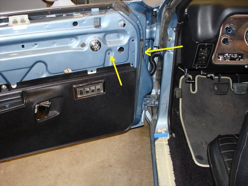

I actually still have my clips attached. I can send you pictures tomorrow. I just wasn’t sure where they went and i can’t seem to find any diagrams.

You will find a hole in the front of the door shell one clip fits into, the second clip goes into another hole between the fist location and the control mounting location. The clips hold the cables out of the windows way.
If you can't find the correct clips, I just used a zip tie, through that hole in the front of the door, around the cable, then back through the hole.
The head of the tie was big enough to keep it from falling in the hole.
