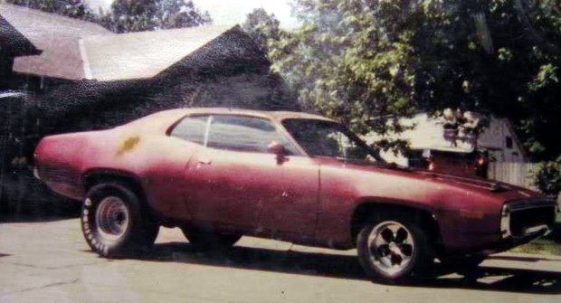

Nice, When I was a kid we shoved 2x4s between the coil springs to raise the rear.
