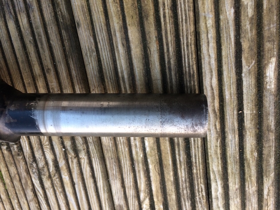

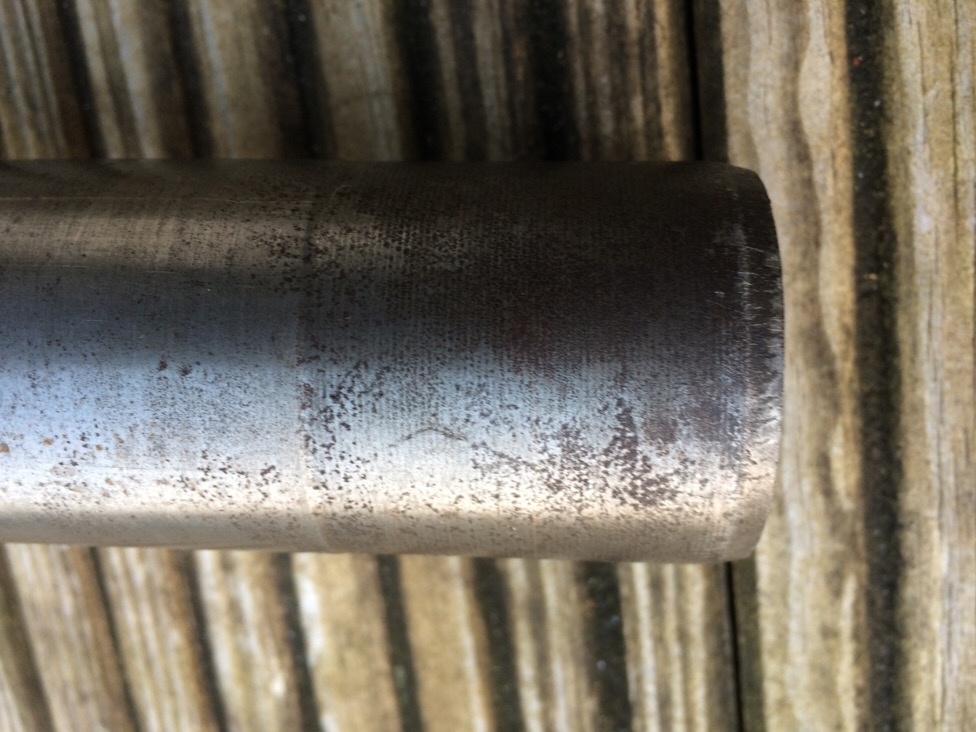

The actual yoke has a wear step about 2" in from the end. What might cause that?

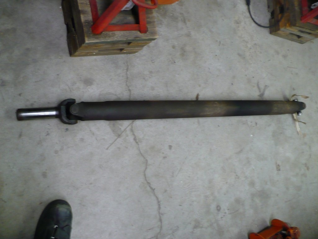

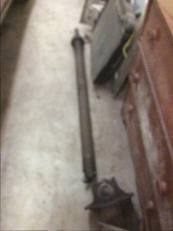

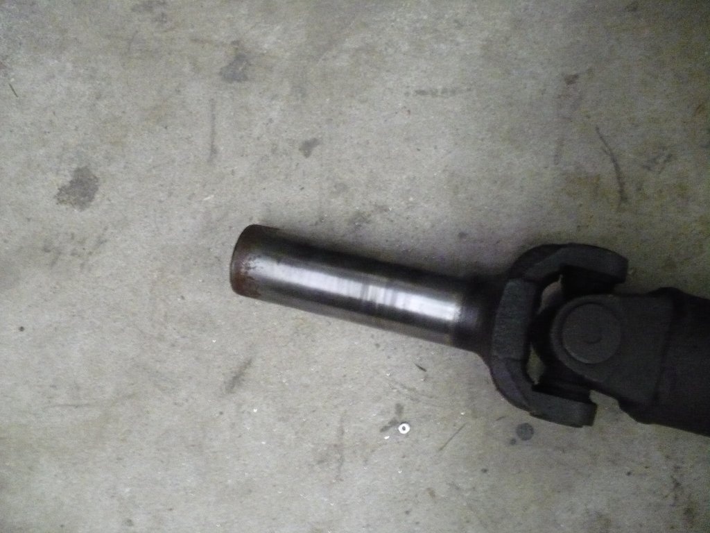

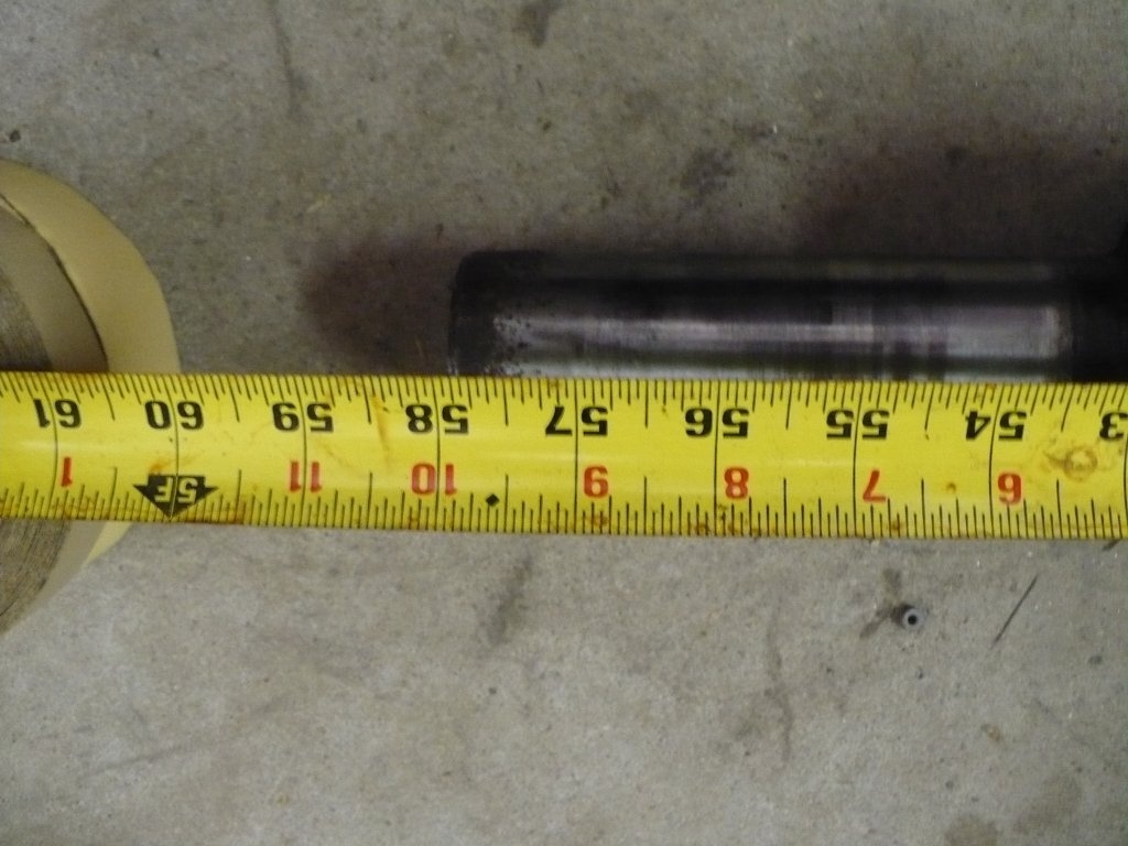

I'm posting pictures or two drive shafts. The one with big donut neat yoke is a 66 and the other is the 68 Gtx one.The picture of 66 d shaft is lousy. First picture is the 68 as you can see the slip part of yoke is 4.5".

To me, that driveshaft looks like about the correct length looking at the wear pattern on the yoke. It "sounds" like your tailshaft bushing/seal has gone bad maybe. To be sure, you should have some "up & down" slop if you grab the yoke/driveshaft & try to move it.
It's worn Late this fall going to pull tail shaft and replace bushing. Will also switch out the manual valve body while I'm at it. Why don't I do it now? Last year sold the non-original Dana 60 and opened a can of worms, not this year. It will survive another 500 miles, I want to drive it this summer. Those two drive shafts aren't for my car. One with the inertia ring on front is I think a 66 8.75 Charger shaft the other is a 68 GTX with a Dana shaft. Extra parts.
