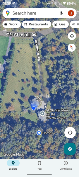

They call it ravenrock Rd here...but it's my driveway
For reference, the white car between the house and garage is my old XJ Cherokee. The other car is a Daytona under a cover.
The driveway also goes to the right of the garage, from the covered Daytona to a door where the "Re" in "recently viewed" is.
It's a LOT of pavement.
For the money he quoted me, and the fact he said it'd take at least 300 gallons...it's not worth my time to buy brushes and DIY.
