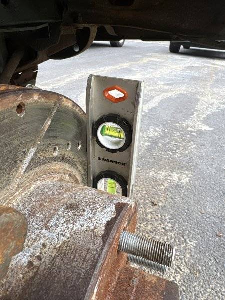

I finally put together the front end and put the wheels on. I tried moving the car back and forth and feel and sounds like the damn wheels are going to fall off. :BangHead: I put a level and it was a couple of inches off, it not more. I want to get it a little squared away, but what's the best way to give an alignment to get me to the alignment shop? I was thinking of putting it on its weight, do the string thing and try to get the wheels closer to being level. What do you guys usually do?
How assembled is the car? What do you mean by "on its weight" Pics will help. What is a couple inches off. Caster? Camber? Toe?
With full weight, just use a regular level on each side to get 0 camber, tape measure across the front of the tires vs. the back of the tires to get an approximate toe. That will get you to the alignment shop.

When I say on its weight, I just mean sitting with the wheels on. I will take some pics tomorrow. I am thinking the caster, camber and toe is way out of whack and causing the problems I'm feeling and hearing. I replaced the upper control arms and had to change the tie rod sleeves, the prior owner must have used the wrong ones. The sleeves would never tighten, but now they are good, nice and tight. I tried to keep the rotor straight as I was installing the sleeves, but who the hell knows.
