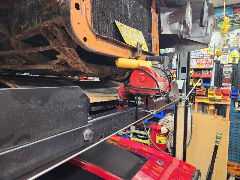

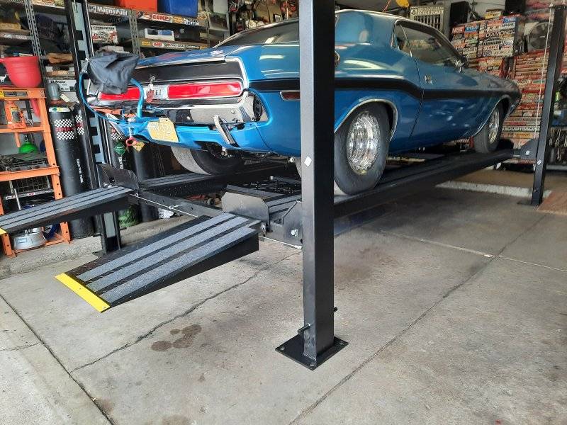

I just drive up. The runners are more than wide enough to ever miss.
I did add friction tape up my ramps and on my runners just so a vehicle with wet tires doesn't try to spin the tires and slip off.
I made brackets and added a winch to ease with pulling up a non-running vehicle when needed.
I also added magnetic LED strip lights. No drop light ever needed while working under a vehicle.
I added a cheap Homey Freight wireless winch to the front of my lift as well to drag the GTX onto the rack. Still need to get around to adding some lights for working under the vehicle.
