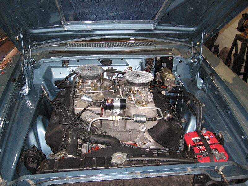

Ran the Pertronix I in this Hemi that revs well past 6,000 rpm.Worked flawless.

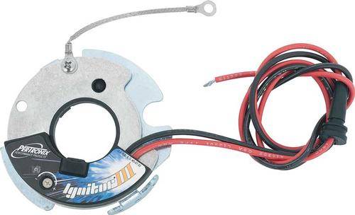

I had linked the III because it's the most advanced, multi-spark and rev limiter, and that is the "module" the billet aluminum Pertronix distributor I got for my wife's GTO has, although I bought it as a complete system.
