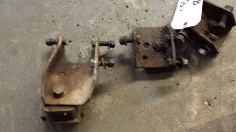

^^I did find a guy over on FABO that has a set ofLA 318 and poly 318 brackets, the plys are quite a bit shorter and the K for 64 has longer "ears" than a later Lthat takes a LA engine. He is sending me the poly brackets and that should be the answer.
I understand that all the brackets for poly and LA engine all fit a LA block, yes some require a little tweeking at the block.

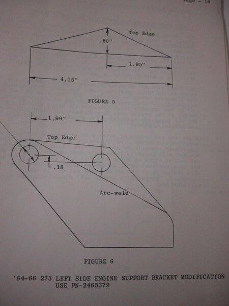

Any chance we can see "page 19" lol? I'm doing a Poly to 360 swap and im not sure what I'll be into for the motor mount. its in a 65 Coronet by the way.

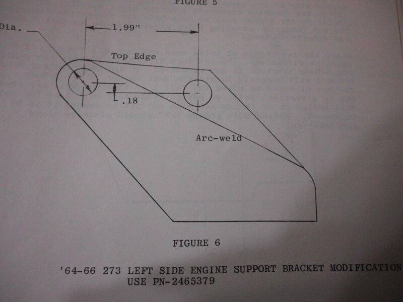

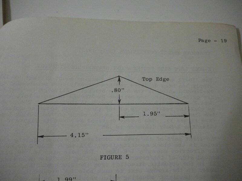

Here's page 19. Hope it helps!
Both the Poly and LA brackets mount to the blocks the same. Same bolt spacing and what not. Difference is in the height of the bracket and of the towers on the K frames. 63-5 towers are a lot taller than the 66-72 towers. There for the 63-5 poly brackets are much shorter then 66-72 LA brackets. That being said I think the key is using the correct brackets for the K frame.
