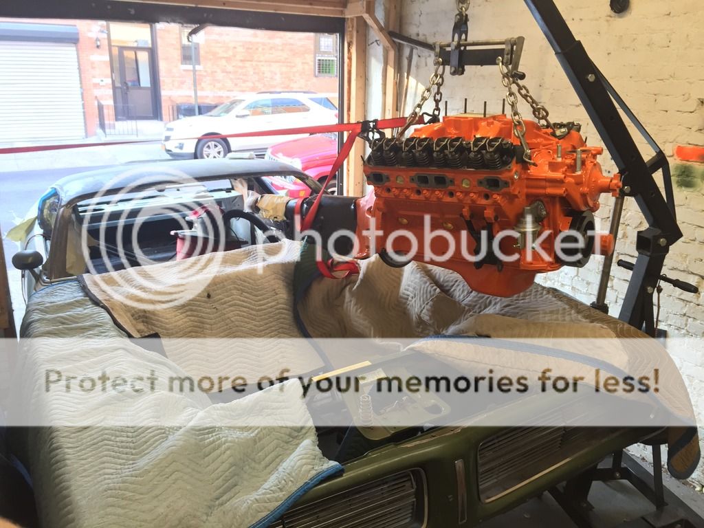

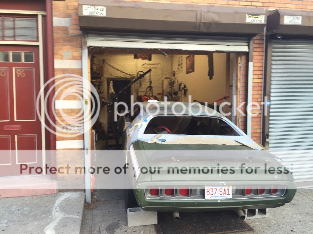

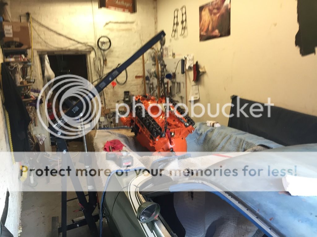

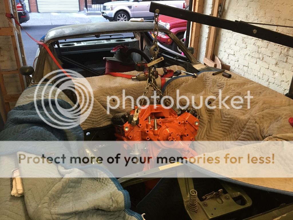

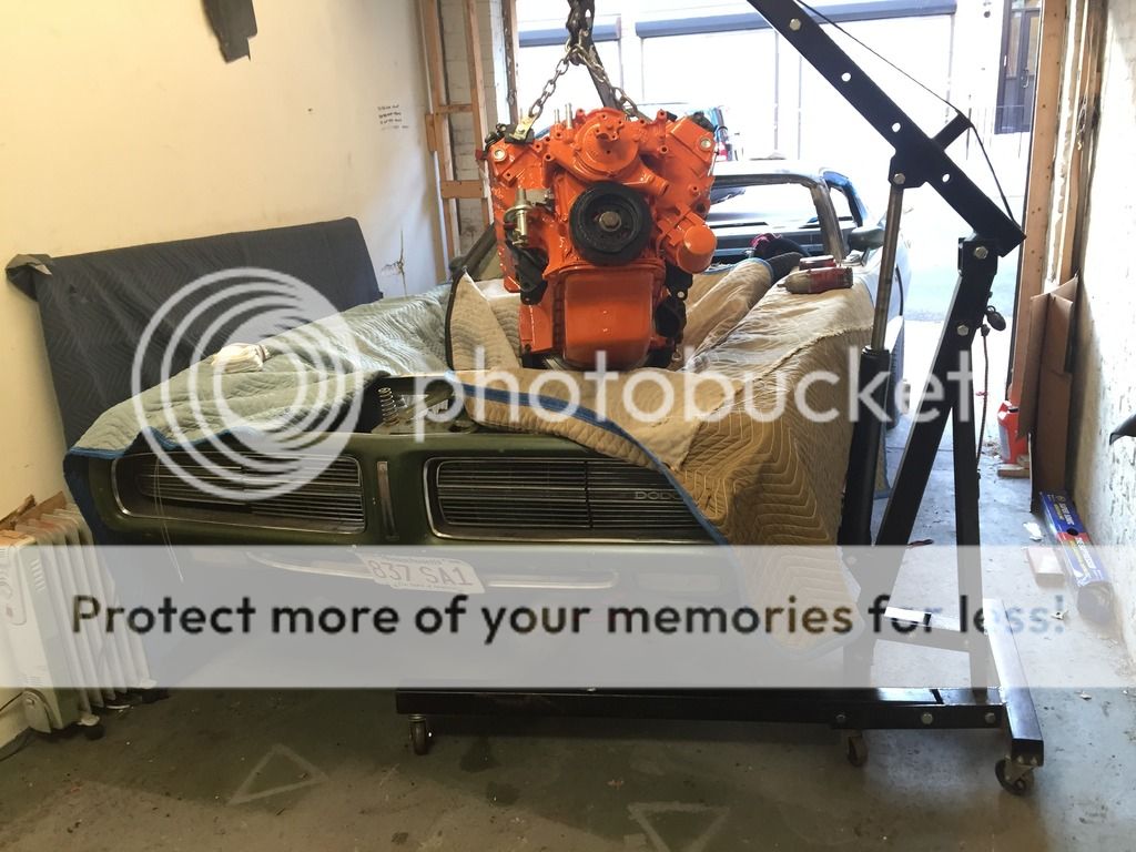

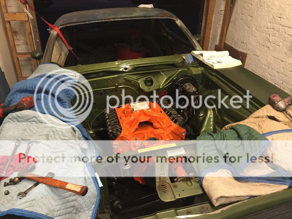

So, i got it in yesterday. Decided to attach the trans to the motor. Took off the driver's wheel, went through the side. Didn't really jack the car up at all, just went in at an extreme angle. I'm happy!!!!
Well i just saw this. You did what I always do come in from the side the cars to long ,unless the front end was coming off then I go from the front . Looks good though .
Nice job !!!!
Nice pictorial:grin: Ihave never seen a cherry picker used from the side,that's pretty cool!
