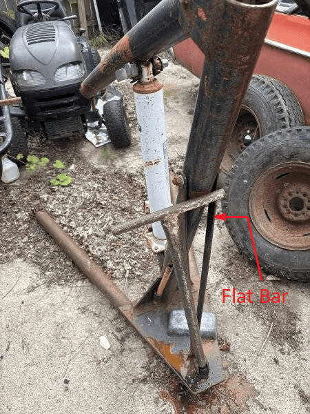

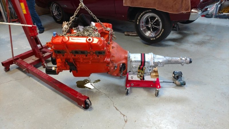

Well THIS was exciting... and unexpected... and dangerous!!!
Without the flat bar straps the leverage of tension on the bolts at the bottom of the mast is Phenomenal!
The Flat Bars work like the Strut rods work on your lower control arms.

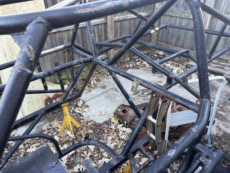

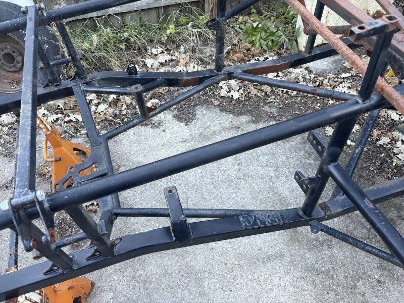

Maybe but not enough of a triangle to make much strength.

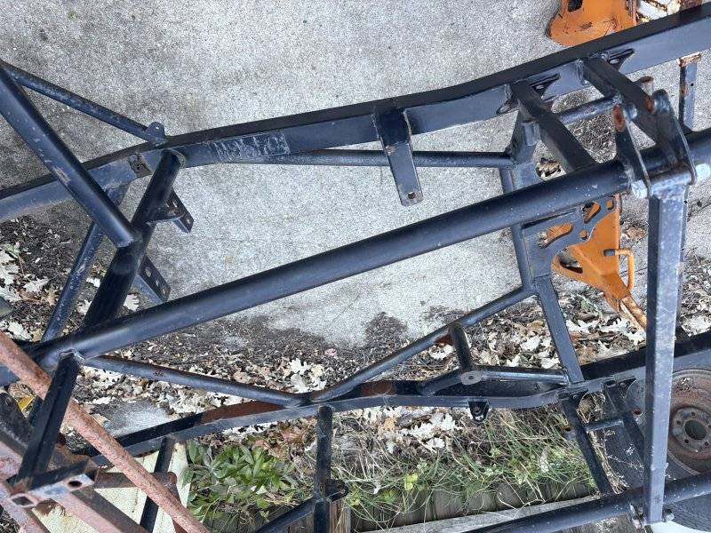

I think I have a handle on triangulation... unless you have some kind of opinion on my fab skills on this old dirt car chassis I have redone
Sorry forbthe upside down photo
It doesn't take much to topple the mast on the hoist.
It also doesn't take much to properly triangulate it.
But I guess you're smarter than EVERY engineer who designed a cherry picker hoist.
I'm not a mechanical engineer.

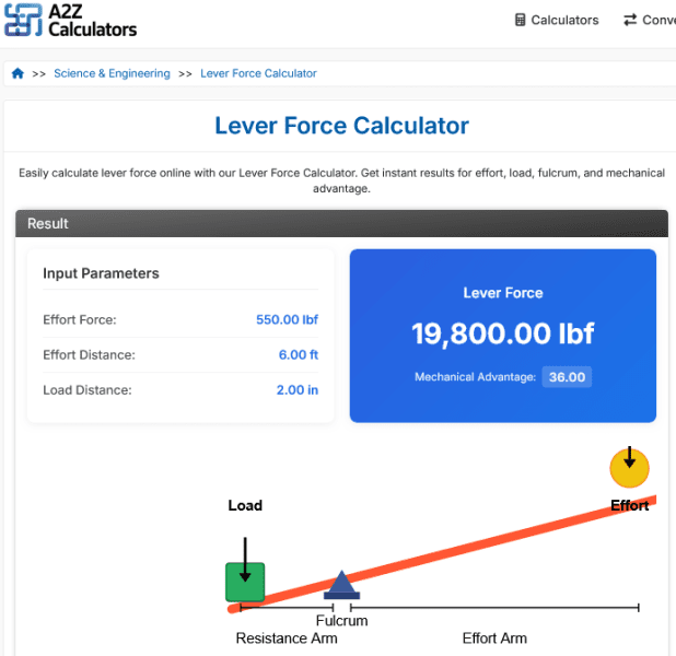

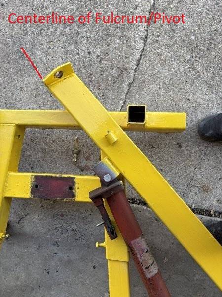

I've guesstimated the distance your engine was from the fulcrum (red line I drew in a previous post).
Without the straps there is an unnecessary class 1 leverage vertical load on the base bolts, that shows now in the twisted ~2" x 4" flat plates at the base.
If your motor was 6' from the base.
You be you, but if it was me I'd take the L on this one and move on.
