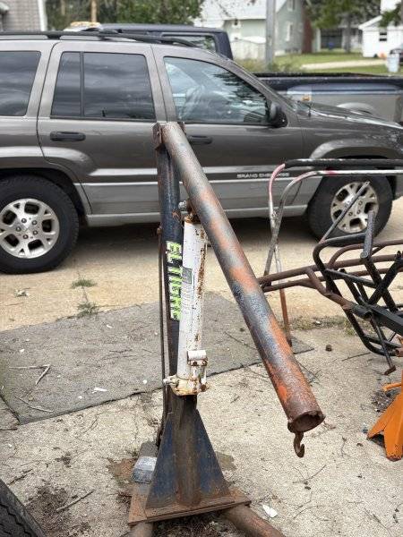

Those "Unnecessary Show Straps" provide an additional 66.6% load support for the hoist. They are used to prevent the boom upright from tilting forward like yours did and breaking the bolts. The reason the back of the hoist was going "*** over Tits" was because the legs were not extended and the center of gravity for the load was too far forward.
1) The legs NEED to be extended when lifting heavy loads
2) The upright straps NEED to be installed
3) The proper hardware & bolt lengths NEED to be used
On a side note, I would suggest you download a manual for a "Cherry Picker" and read it before you kill yourself or someone else. Thankfully no one did with this mistake...

Uhh, you are proving the point that many have made about supporting the mast with additional reinforcements. This one has those straps that you seem to think are not necessary...
In engineering terms, without the straps, your mast is under shear stress, with the straps, it’s under compression, and the straps under tension.
I would bet you could lift an engine without any nuts on the bolts of the mast when properly assembled.

By the excess washer count from that bolt, I would put money on it that it was over torqued (stressed) when initially assembled.

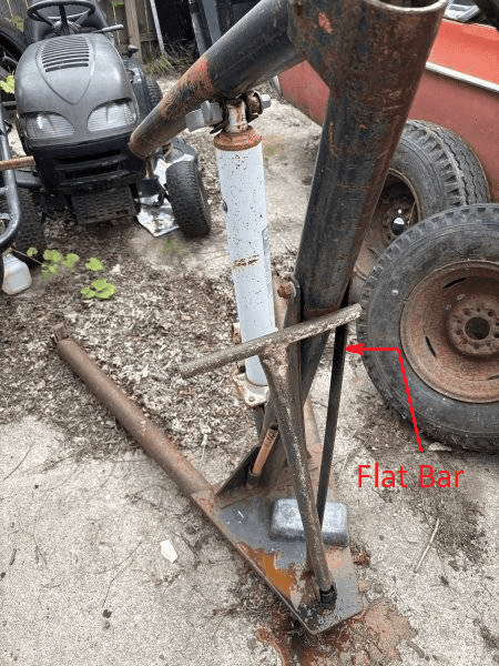

The flat stock is only potentially "flimsy" under compression - the side the boom is leaning TOWARDS.
However, it is ultra-strong in extension, or, the side the boom is leaning AWAY from. This MORE than counteracts the compression side, because (through triangulation) it keeps that side from compressing in the first place, because it keeps the boom from leaning away to start with.
Your bolt didn't break because of the weight of the engine on the end of the boom. It broke because the boom tilted sideways, due to the lack of bracing. There may have been other issues, but the lack of bracing exacerbated any other smaller issues, and compounded them until failure.
Install the braces. They're there for a reason. And, extend the damn legs when you put a load on. Your lift point should NEVER be outside the ground footprint.
Gravity is a LAW, not a suggestion. Same with physics.
Without the flat bar straps the leverage of tension on the bolts at the bottom of the mast is Phenomenal!
The Flat Bars work like the Strut rods work on your lower control arms.
