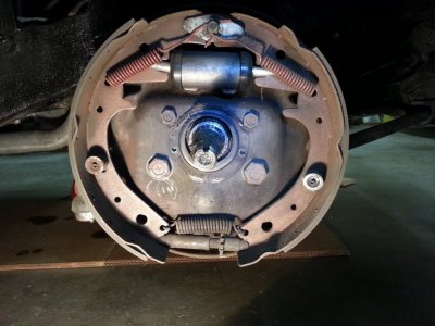

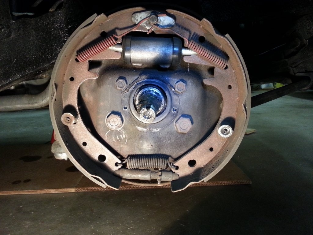

It seems all of my old aerosol cans are out of gas; no brake kleen. Here is a picture raw with no cleaning.
No self adjuster, also?
If I remember correctly they did not have self adjusters.

It still looks relatively clean. From the picture the cylinders look good.
2 days ago I helped my bro-in law with rear brakes on his truck. Yours look much better.
Some shoes and you should be good
