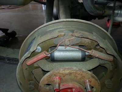

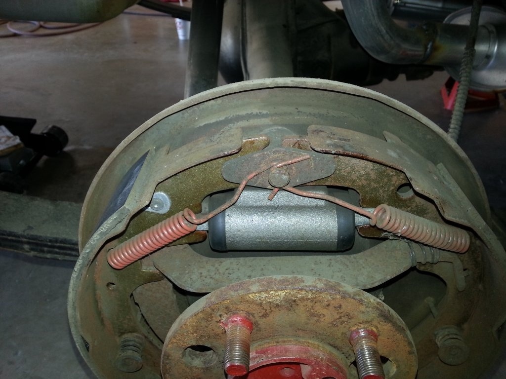

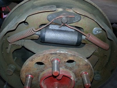

For what it's worth...off the photo above. See anything wrong?
The shoe return springs, up top, one for each shoe, should have a 'hook' bent in the ends that fit over the center pin. The one spring looks like it's just sitting there.

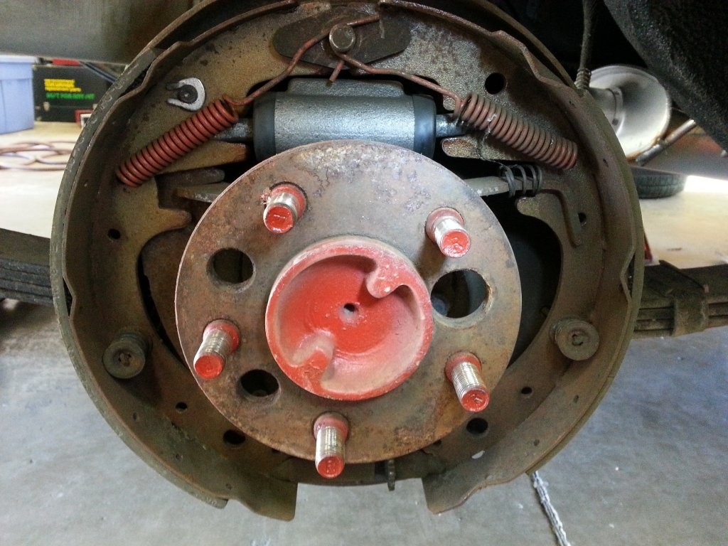

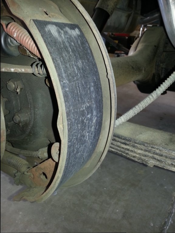

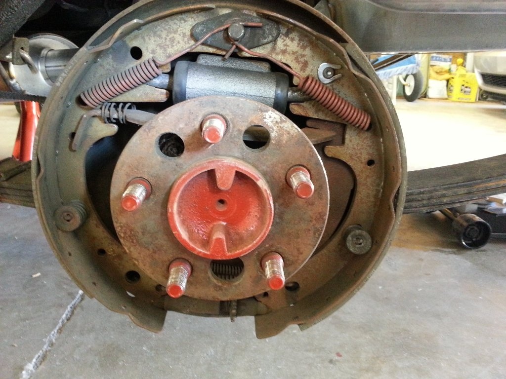

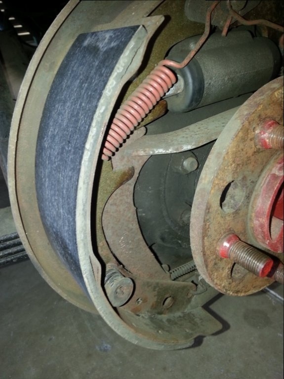

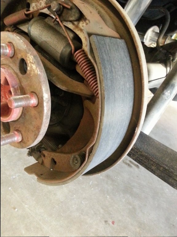

Hi Experts!

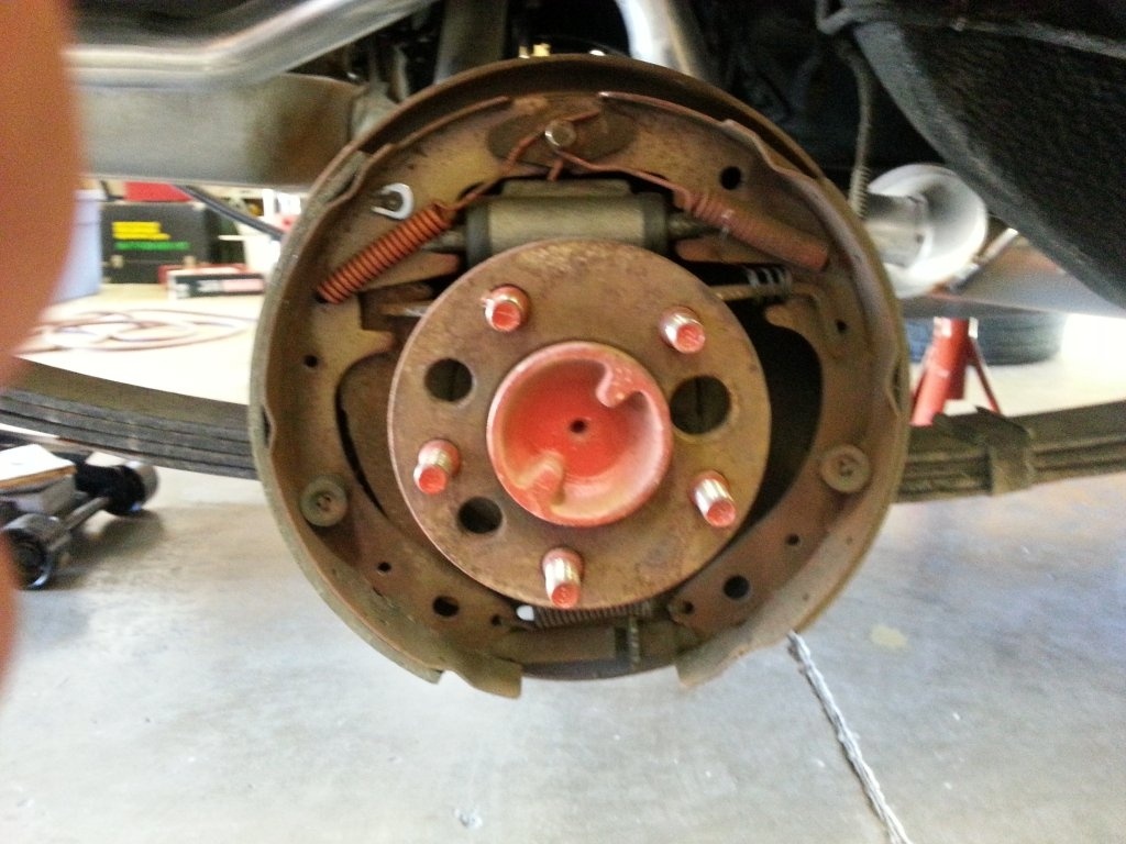

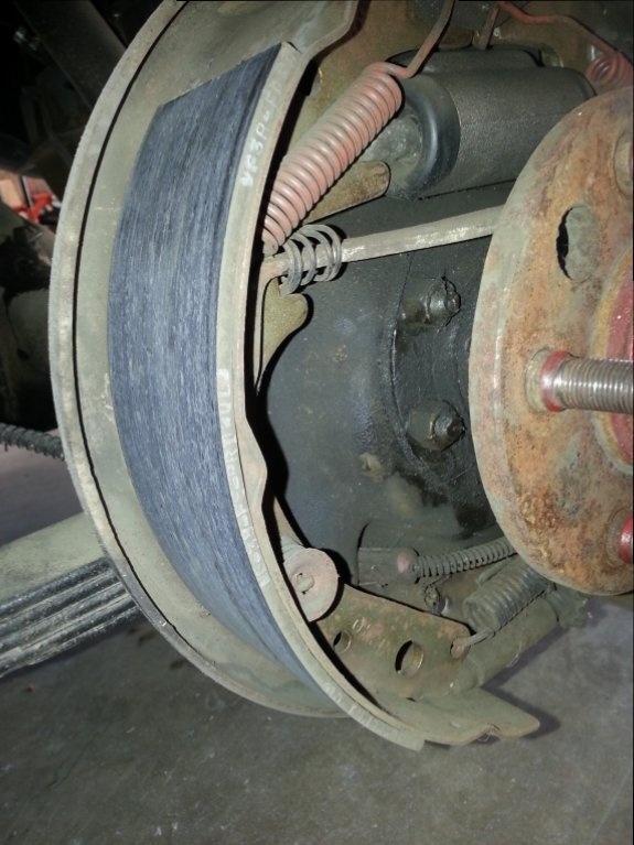

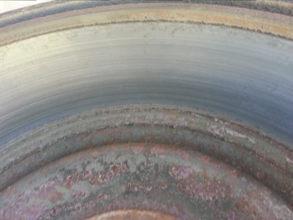

I finally pulled the rear drums. Wheel cylinders are dry, don't really see any leaks and the shoes look fairly new (like the front). The drums don't look as nice as the front. What do the experts think? Link to photos below:

No vibration when braking? Run 'em. One little tidbit I noticed; I would squeeze the upper return springs a little bit to close up the loop over pivot pin(?) don't go crazy just tweak them a little.

Has the rubber line that runs to the distribution block been replaced?
Adjust those like the front. Get em tight and back off until they dont rub. I can't see the pic:(
Optical illusion. Zoom in and you can see they are both hooked over the pivot.
