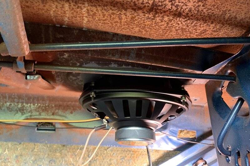

All my cars have the 2 different size holes as well. You can use 2 6x9's by hanging them under the package tray without cutting the small hole bigger. I use long #8 or 10 machine screws with nuts to secure.

That is correct. Same here on my 68 Coronet. You can mount 6 X 9 speakers on the 5 X 8 speaker mount.
that is how I did mine

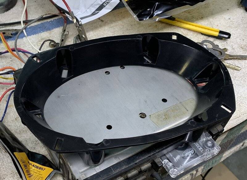

just going to throw this in if interested. I just installed some 6x9 to 5x7 adapters in my 77. my car has a 5x7 hole on the drivers side and 5x7/6x9 hole on the pass side. these adapters are nice and made the swap easy.
