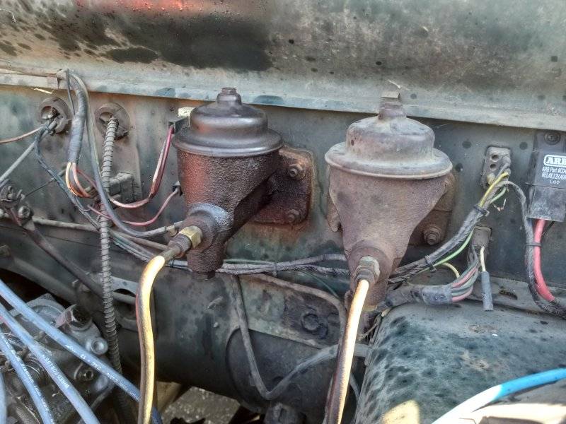

At one of the shops on my route today I see a cool 66' dodge truck. I go to check it out and notice it has two side by side single master cylinders with a hard vacuum line off the top of the intake feeding a brake booster under the dash. Is there any real advantage to doing it this way? Im guessing this was the same engineer that implemented the left hand thread lugnuts.

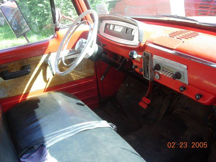

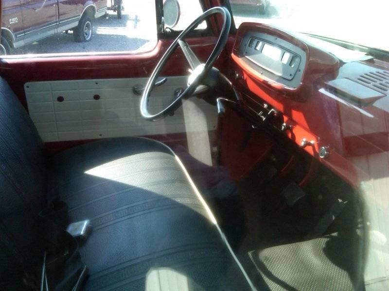

Picture worth a thousand words but in this case more questions. Pictures under dash? Are both for brakes or is one for a clutch arrangements? Needed more room in engine compartments for PB booster?
I didnt take a picture under the dash but I was talking to the owner of the shop(one of the best mechanics I know). No clutch it was an automatic 4x4
The one master cylinder is for the clutch. The leaver you saw was probably a three on the tree. The automatic trans had a shifter on the dash.
Three on the tree...
Automatic...
Mid sixties Dodge trucks did have a master cylinder for the hydraulic clutch. I had a 65 model D100 with a slant 6 that had that setup. I bet that truck has been changed, and the old cylinder left in place on the firewall. (Probably to mess with people that ask the question.. LOL)
