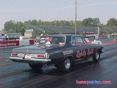

Here's what I used. If you notice the small secondary jets on the 3705's are in the outside of the intake. One carb faces in each direction. The 3447s are the same side to side. These were Chrysler dyno jet numbers done in house under controlled conditions. Take for instance the .104/.053 jet/rod vs the .089 jet by itself. The difference in area is only about 3%. So beside the choke side secondary jets being small (cylinders 2/7) not much difference. My car ran 10.1X@132 best. Your issue might be lack of hood scoop. Not the the scoop is that great, but the carbs are very close to the hood. Like I said, not much difference.

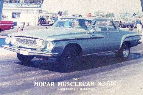

you are far more advanced in them now than we were then. my' '63 had hood scoops albeit not the mopar scoop, they were not available yet if your car didn't come with one, mine was the 415HP,no scoop or alum front end. the day I ordered my car the bulletin came out about the Alum group offer, I ordered it but didn't know they were only available on the 425 HP version. my scoop(s) were the Ford truck air intake on the side cowl that had screen to keep out the rats and mice. they look pretty much like the later scoops on the Pontiac scoop. my '62 clone was never going to get a scoop as they were not available in' 62, I was making it faithful to the year. I even ran the stock exhaust and centrifugal advance duel point distributor.
so with the 3.90 gears and all factory trim and the tired 440 short block I was pleased with the 109 top end, would liked to have ET'd better but? at the next race after the picture, the SS cars were lined up waiting for a run, first run was about 10AM ,at 3PM we ere still waiting fort a second run, cars in other lanes were doing laps, I asked the staging lane director when we'd get another run, he became belligerent and told us to wait in your f**king car till we call you. I got out of the lane,went back to the pits, took it home -then took it apart and sold it, the engine/exhaust went to Seattle Washington , the car now running with a '68 hyPo 383 (stock, went to a friend. really regret that as well, I purchased the '62 all stock,never wrecked, never rusted, no damage ever with a 318, for 2K, after cleaning from underside up-I jacked the car up about 3' off the ground removed everything from the underside and cleaned it with wire brushes and tooth brushes till it was literally spotless, had a painter friend repaint the underside with light gray gloss epoxy, it looked better than the original blue exterior. it had new interior andafter installing the 383 I sold it for 2 K, pretty stupid looking back. I excel in stupid. thanks for the great information and memory jogs.

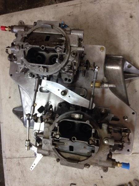

I made a third top for the manifold back to the Carters and turned them sideways like original crossrams. threw away the holleys, they each weigh as much as a VW.
