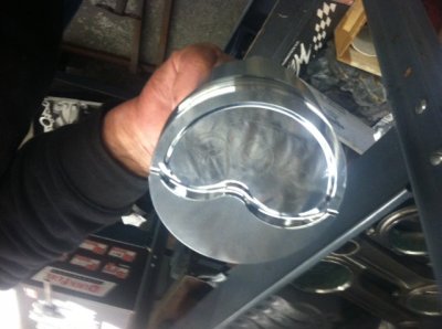

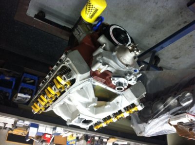

STROKE IT, Just got my 496 dynoed,Eddy rpm 84cc heads, Performer rpm intake 850 demon carb, Eagle 4.15 stroker crank, rods,icon 40 over pistons,final compression 9.7:1 crane hydraulic roller cam #HR-230/352-2S-12 with 1.6 rockers, cloye's double roller timing chain, milodon oiling system.ATI damper TTI 2" headers / 3" x pipes exhaust, msd ignition 18 initial 36 total.motor made 536 hp @ 5200 588 tq @ 3600 runs made high 500 toque #'s from 3600 to 5500, great on 93.pump gas gonna try lowering the octane once i get a feel for the old girl so to speak only got 300 miles on her. plenty of grunt for a street car piston.jpg[video=youtube;WjjneSiNKhY]https://www.youtube.com/watch?v=WjjneSiNKhY[/video]motor.jpggtxxxxxxx ya  2.jpg
