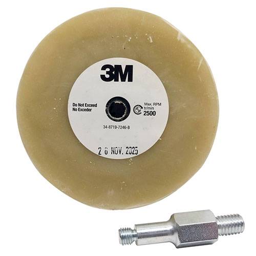

My black Super Bee has a white stripe, and it's ok, but I'm really keen to remove and replace with a red stripe. From the factory, the car was B5 blue with a black stripe, but when it was restored by someone else, it was painted black; so I'm pretty much free to do whatever stripe I want now. The white just looks kind of boring compared to a red stripe.
Anyways, other than using my 3M removal wheel, is there a quicker way to remove the stripe?
If it's a sticky backed graphic, get a heat gun and some nylon single edge razor blades and get to work!
Erasers work good at slow speed. To fast will blister the paint.
A heat gun works well at a distance. As long as you move the heat gun back and forth to keep the tape warm for peeling the decal off.
The use wax and grease remover to rid the panel of the excess glue. No thinner or reducer.
