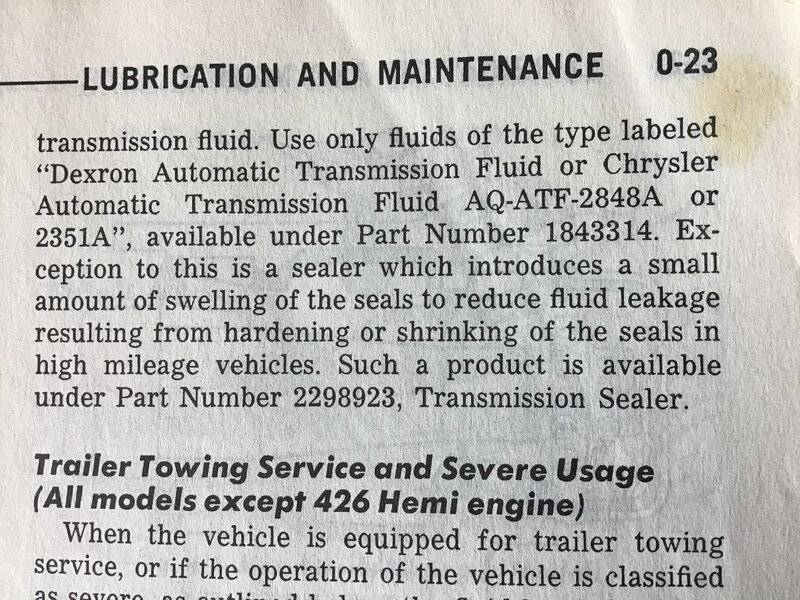

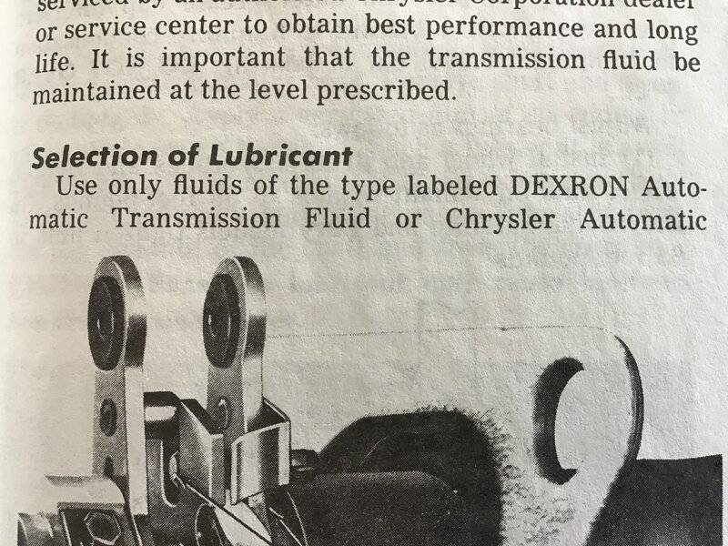

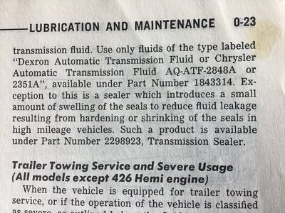

Here is the page from the 1969 and 1970 factory service manual. DEXRON is the fluid the folks who build your Car say to use. There is no letter T in dexron.
Non of the factory chrysler books mention type F
Type F has the worst lubrication quality of any ATF. If you want firm shifts then build the trans to suit.
