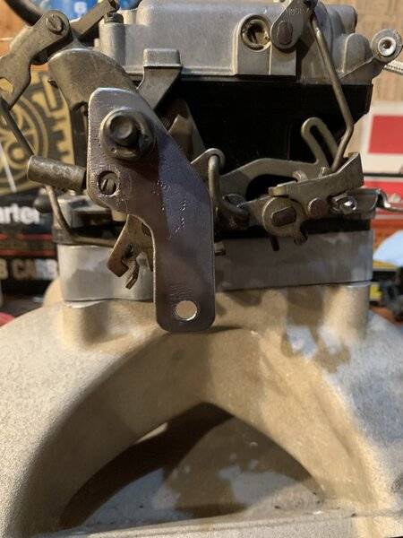

(P.S. That home made bracket is a Lokar trans cable hook up point.)

Note the adjustable throttle linkage and the manual choke cable bracket on the race TQ below.
