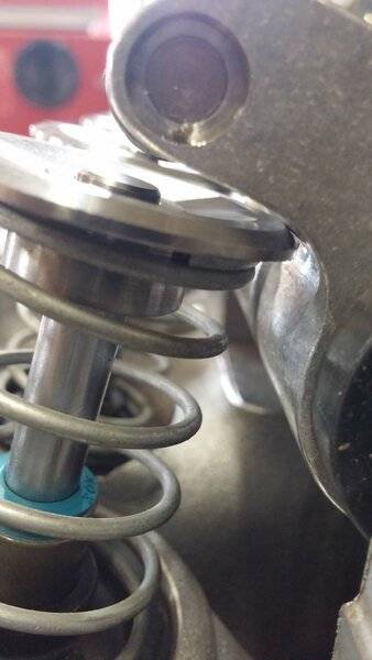

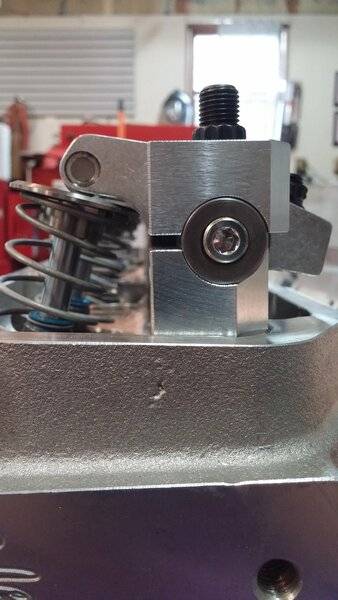

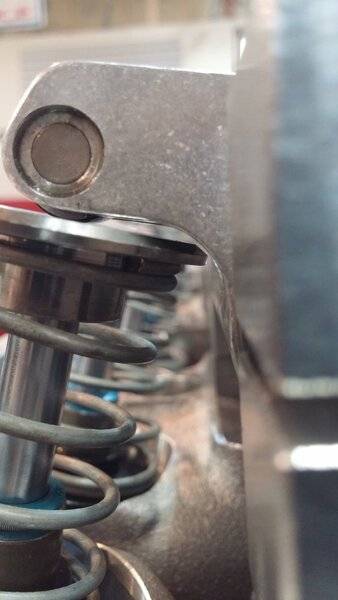

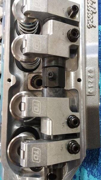

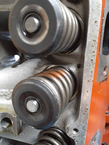

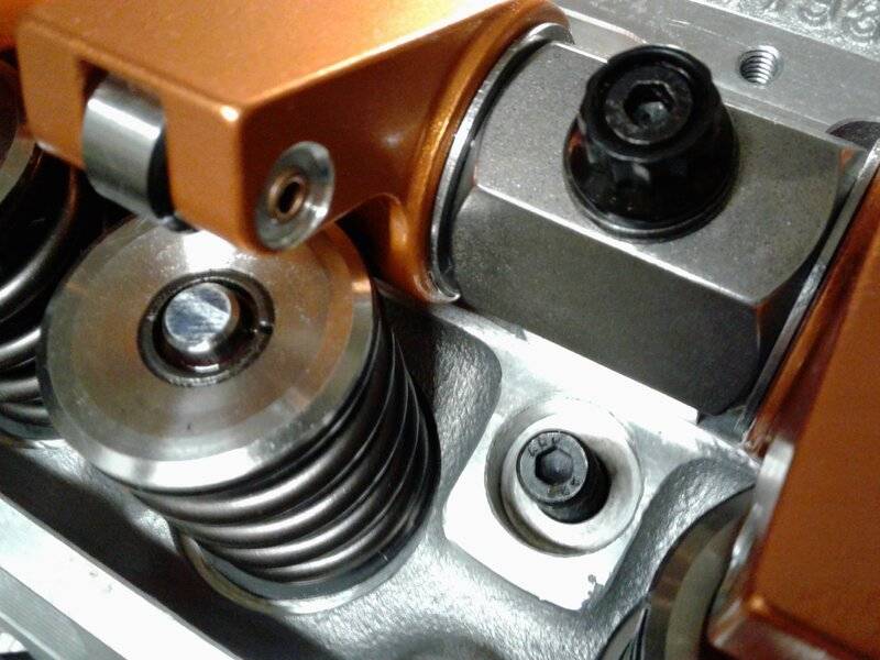

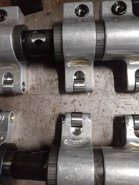

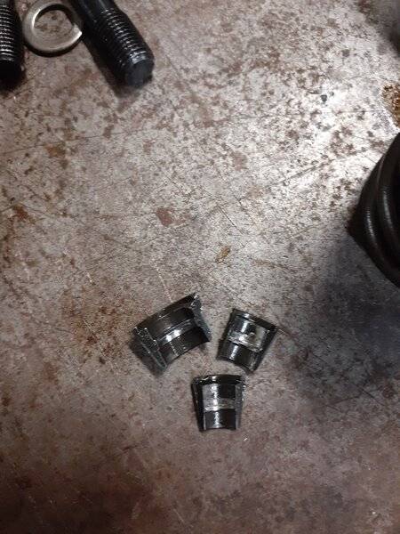

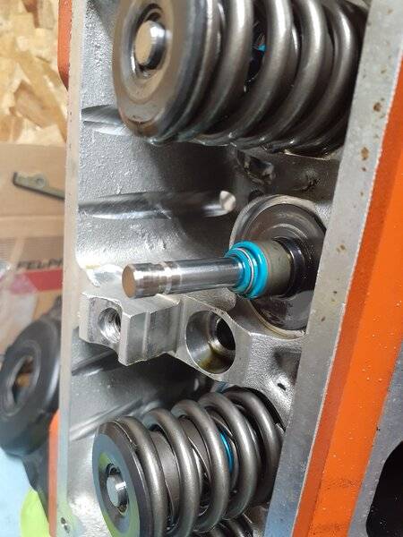

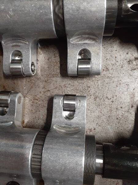

hi maybe some one here is having the same problems i have this is the second time having valve stem keeper problems and retainers hitting the rockers
here are pics

Start researching Mopar rocker geometry. Lash caps may keep the rocker from contacting the retainer, but will make the true geometry worse, and that is the root of the problem here. From the damage I see, you are lucky you haven't dropped a valve yet. The thing about luck is, it always runs out. Take care of the geometry, and avoid a major failure.
Also, don't buy any new parts until you have a plan to fix the geometry. There are options that will save you a lot of headaches and money in the long run.

unfortunately when i got the motor from the builder the first time it dropped 3 valves and busted 3 pistons
For heads that are supposed to be “race” parts, those have a pretty short nominal installed height(1.900-ish).
If someone is looking for more installed height and employing parts like taller installed height retainers and/or locks, you can end up with a situation like you have there.
Might be time to rethink the current spring/retainer/lock combo so you end up with the valve tips sitting more proud of the retainers.
Those are some of the items that need to be carefully scrutinized during the mock up and assembly process...... and hopefully avoid what happened with this build.

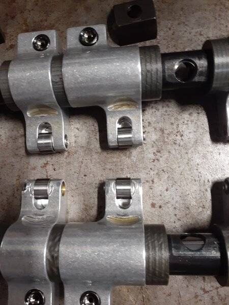

Unfortunately, for being a "race" head, the shaft stands were not put in a reasonably close location to have good geometry, and no amount of fussing with the spring and retainer combination will change that. One only has to look at the Trick Flow heads to see how a relocated stand eliminates these issues with increased installed heights. Here are some pics of corrected Victors, before we had improved rockers available for them. In this instance, it was necessary to remove the stands and make new, which is no longer needed with the new rocker design.
Relocating the rocker shafts would not have solved the issue on the OP’s heads(using the parts they were assembled with) with the sides of the rocker, at the roller, contacting the retainer adjacent to the locks.
Maybe the OP can fill us in on whether the valve tips are actually below the top of the retainer/locks. It doesn't look like it to me, but the angles may be giving a different perspective.
