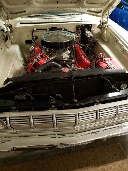

Carb is a Demon 750. Same as Holley, and the air cleaner is a 3 inch, standard base
