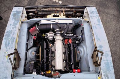

First, go to https://forums.edelbrock.com/ and create an account if you haven't already.
Second, I am just running 2 stock 3/8 metal fuel lines from Tank to engine Compartment.
Third, there is an elbow that should work perfectly, let me find it.
View attachment 1097477 View attachment 1097478
Thank you Derwud! Funny enough the second I saw your pictures in your post I recognized your build from searching the Edelbrock EFI install on google images. So even without you knowing it you've been helping me as I've scrutinized some of your pictures for how you ran lines, electrical, throttle and kickdown cables and so on. Its nice to be able to say thank you!
The fuel lines themselves weren't an issue for me. It was how to get the return line back into the tank. Did you weld a return fitting into your gas tank or did you find some other way to handle it?
Below is the elbow I ordered for the intake for the time being. But I'm all ears if you have something better. I just ran out to measure my clearance between the throttle body and fan. Its just over 5.5 inches to the back of the fan blade. I haven't been able to find a 90 degree elbow with that tight of a bend other than the cobra head.
https://www.intakehoses.com/product-display.html?Product_Code=90CB50R40B

I blame @Dennis H
Here is an Elbow.
https://www.summitracing.com/parts/afe-59-00113
Tanks Inc and Aeromotive make F.I. Tanks with a in-tank pump. Get one of those.. (I am using a 66-67 Charger tank for my Wagon) Send the other stuff back.. I am sure the is the message from @Dennis H
https://www.summitracing.com/parts/TNK-TCR14-T-KIT
