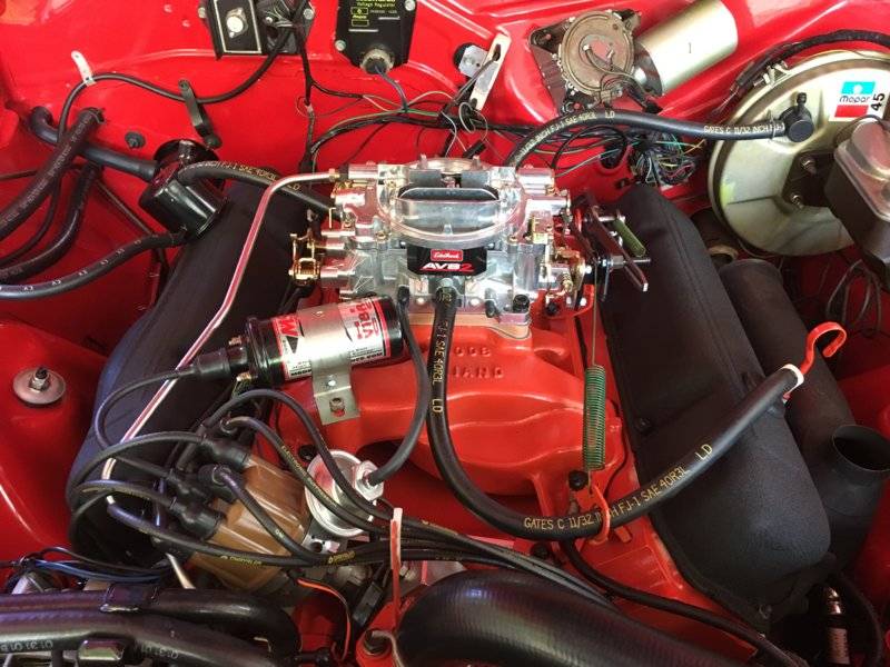

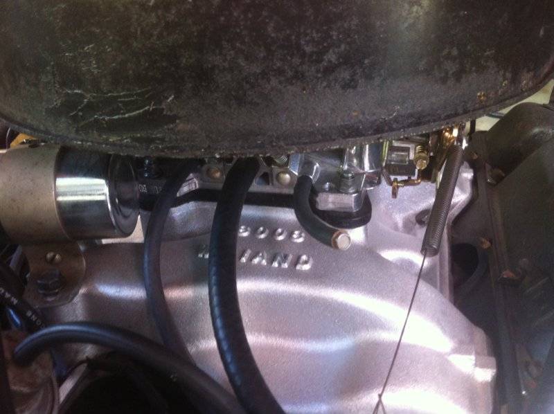

Anyways I went from this for many years running Carter AVS and various Edelbrock carbs
https://www.edelbrock.com/heat-insulator-gasket-for-open-4150-square-bore-0-320-thick-9265.html
To this , when I installed my AVS 2 800 cfm on my Weiand Dual Plane last month
https://www.edelbrock.com/carburetor-spacer-4150-style-1-2-open-spacer-wood-fiber-laminate-8724.html
Man what a huge difference , car can sit for days now and fire right up as before had to crank and crank pumping the go pedal until
Drove the car 100 miles one way yesterday in 90 degree weather at 3200 Rpms , sat at a car show for six hours , fired right up after , perfect

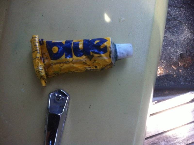

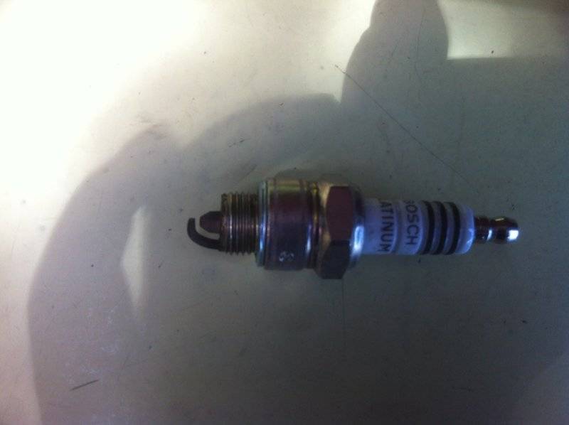

Ooops, I forgot that i applied Hylomar to both sides and a pic of my cheap Rockauto warehouse clearance $1.17 Kraut sparkler
