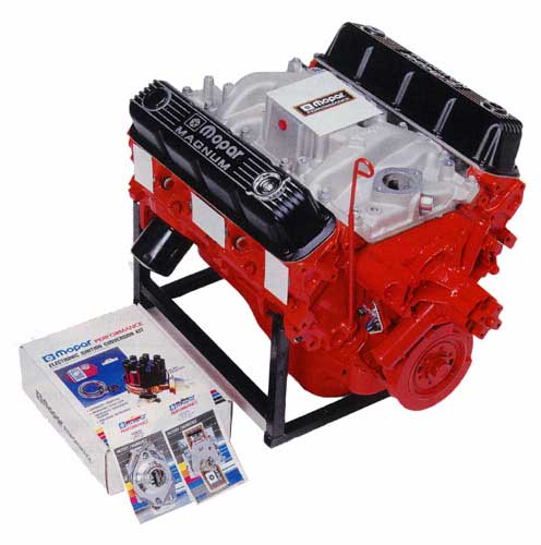

[FONT=Verdana, Arial, Helvetica, sans-serif]Back in 2005 I bought this crate motor from Summit for $3499. Its a new, not rebuilt, Mopar Magnum 360. ( It was classified as a Magnum 380, This is the 380 hp, 411 torque) It recommended a 750 carb, and is not recommended for A/C. Keeping it tuned has been a chore, going through a set of plugs every few months. Plus it has a nasty, nasty cam when timed to where it runs correctly. My question is, I've thought about converting to EFI. Either getting a stock EFI manifold from a newer Magnum engine, or getting one of the EFI kits, that either replace the carb, or the intake. Question, If I do the conversion, will it run LESS radical with the cam, since the timing will be controlled by the unit, and if I used stock engine configuration, any chance I might be able to run A/C? The Mopar intake on it now has the thermostat housing closer to the passenger side, thus making stock A/C location unusable. Since this IS a production Mopar performance engine, any chance their is a set up designed for this specific engine?[/FONT]
[FONT=Verdana, Arial, Helvetica, sans-serif]PS [/FONT]
[FONT=Verdana, Arial, Helvetica, sans-serif]Bottom line, I removed this engine, and swapped a mild 360 ( Much to my friends surprise ) because using premium fuel, I get valve clatter if i stomp it, and diesels at idle if the RPM's rise. Don't get me wrong, its the most powerful motor i've ever owned, as my brother calls it, A race motor.. Can it be a little more civilized? [/FONT]

Bought it January 2005 from Summit racing. The motor was on back order, and I had to wait 3 weeks. The Mopar magnum with 320 hp was in stock, but my 380 took some time. claimed to be be a NEW production performance block from Mopar Performance. 380 hp with 411 torqueP9171585.jpg
Based on the production Magnum 360, the 380-horse crate is built with all-new parts, not the usual rebuild. Inside the bottom end you'll find pump-gas-friendly 9:1 pistons, a hydraulic roller cam, and a double-roller drive. The roller is a fairly stout stick, with a long .288 intake, .292 exhaust duration, and .501/.513 lift-much more than any production small-block. The specs don't hide the fact that this cam will have some bark, so if the lope, rumble, and top-end power aren't the goal, consider backing off to the milder 360/300hp version.
Topping the short-block is a set of Mopar's now-familiar high-swirl closed-chamber Magnum cylinder heads. The 1.925-inch intake valves are slightly smaller than those of the early 340, while the 1.625-inch exhaust valves are slightly larger. As with all Magnum engines, 1.6:1 rockers are standard. This is a tenth of a ratio point higher than the traditional 1.5:1 small-block rockers of old.
The major benefit of the Magnum heads over the old 340/360 castings is the nicer form in the exhaust port. The old small-block Mopar heads had a definite flow-inhibiting area in the most critical portion of the exhaust port floor, right as the port departed from the valve seat. Also restricting the exhaust flow was a big kink in the port roof. The Magnum exhaust port is much improved. On the intake side, the port window is narrow through the pushrod area, owing to the larger clearance hole used in conjunction with the hydraulic roller cam's valvetrain. Toward the valve, the Magnum head's ports take a nice form. The most significant departure from the Mopar small-block heads of old is the combustion-chamber design. The best features of the old heads were retained, including the valve angle and favorable opening axis to the centerline of the bore. The chamber has been redesigned to take advantage of the better combustion characteristic available from a modern closed-quench chamber. This chamber design alone should produce a worthy increase in output over the old-style open chamber heads.
The Magnum crates are shipped with a large cross-section single-plane M-1 aluminum intake manifold, which appears to be a nice design, utilizing a modern sweeping runner. Bosses are cast into the intake, allowing for a multi-port fuel-injection system, although a standard four-barrel carburetor is the induction of choice for most installations. The Magnum crate is fitted with a center-sump oil pan, which is compatible with traditional Mopar body styles. Rounding out the package, the crate comes equipped with MP cast-aluminum valve covers, a damper, the dipstick and tube, as well as the water pump. A complete Mopar Performance electronic ignition system and thermostat housing are included. Add a carb, headers, and accessories, and it's ready to run
Read more: http://www.moparmusclemagazine.com/...ate_engine_buildup/viewall.html#ixzz2Ke8u5nEV
